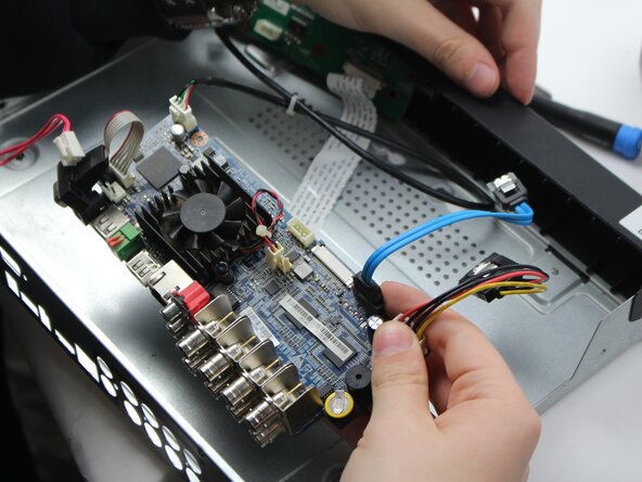

  4. Lorex LHV210800 Fan Replacement, Fan: crwdns2935265:04crwdnd2935265:01crwdnd2935265:02crwdne2935265:0 Lorex LHV210800 Fan Replacement, Fan: crwdns2935265:04crwdnd2935265:02crwdnd2935265:02crwdne2935265:0
    • Unplug the red and white power cord from the socket.
    • Unplug the back panel power source.

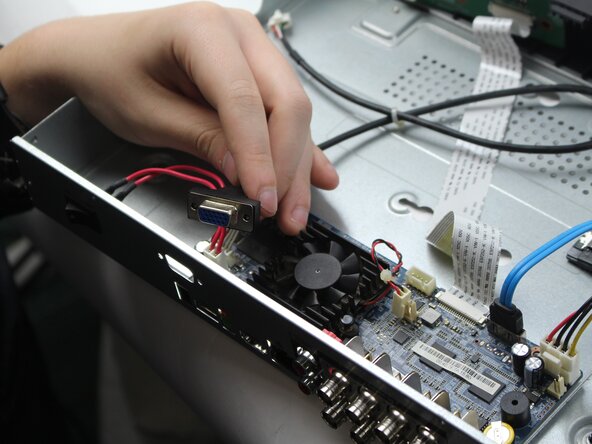

  5. Lorex LHV210800 Fan Replacement: crwdns2935265:05crwdnd2935265:01crwdnd2935265:02crwdne2935265:0 Lorex LHV210800 Fan Replacement: crwdns2935265:05crwdnd2935265:02crwdnd2935265:02crwdne2935265:0
    • Remove two of the 1 cm screws.
    • Remove the back panel where the fan is located.

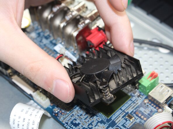

  6. Lorex LHV210800 Fan Replacement: crwdns2935265:06crwdnd2935265:01crwdnd2935265:02crwdne2935265:0 Lorex LHV210800 Fan Replacement: crwdns2935265:06crwdnd2935265:02crwdnd2935265:02crwdne2935265:0
    • Turn the panel around, and locate these two black studs connecting the fan and the panel together.
    • Once you are able to get those loose using the pliers, the fan should pop out, making it easier to switch out the fan and check it for issues.
