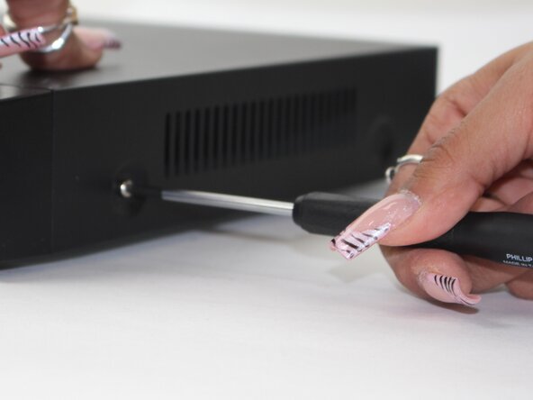

    • Before beginning, disconnect the DVR from power and unplug all peripheries.
    • Remove each of the two 1 cm screws on the right and left sides of the DVR with a Phillips screwdriver.
