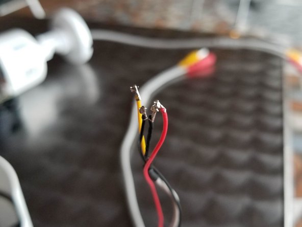

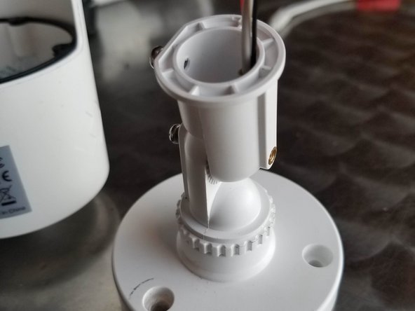

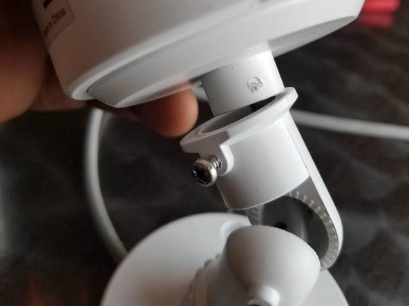

    • The base is fixed to the feet using a single Phillips #1 screw
    • In order to separate the camera from the feet, you will need to undo the connector. The wires are thin so be careful.
