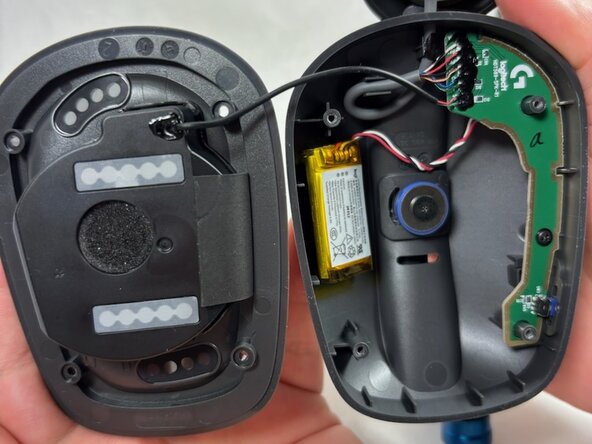

    • Pry open both the right earpad and left earpad carefully with your hands.
  2. Logitech Zone Vibe 100 Battery Replacement, Battery: crwdns2935265:02crwdnd2935265:01crwdnd2935265:01crwdne2935265:0
    • Remove the four Phillips #00 screws that secure the right driver cover.
  3. Logitech Zone Vibe 100 Battery Replacement: crwdns2935265:03crwdnd2935265:01crwdnd2935265:02crwdne2935265:0 Logitech Zone Vibe 100 Battery Replacement: crwdns2935265:03crwdnd2935265:02crwdnd2935265:02crwdne2935265:0
    • Gently lift off the right driver cover with your hands.
    • The cover is still connected by some wires going from a small daughter board to the speaker, so be careful to not tangle, strain, or rip them.
  4. Logitech Zone Vibe 100 Battery Replacement: crwdns2935265:04crwdnd2935265:01crwdnd2935265:01crwdne2935265:0
    Tesa 61395 Tape
    $2.99
    • Grip and pull the white battery connector directly out of its socket.
    • Use an opening tool to gently pry the battery up and off of the housing.
    • Take care not to bend, twist, or puncture the battery.
    • Remove the battery.
    • During reassembly:
    • When installing a new battery, make sure the end with cables is near the bottom of the ear cup so the connector can reach its socket.
    • If your replacement battery comes with adhesive pre-installed, remove the plastic liner and press the battery into place.
    • If your replacement battery doesn't come with adhesive pre-installed, use strips of double-sided tape to secure it in the recess.
