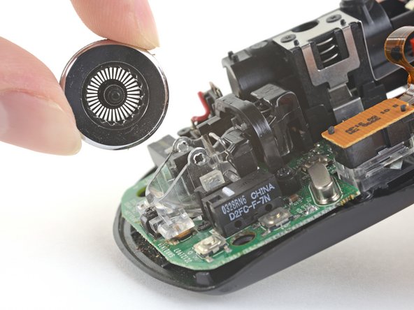

  8. Logitech VX Nano Wireless Mouse Scroll Wheel Replacement, Remove the scroll wheel: crwdns2935265:08crwdnd2935265:01crwdnd2935265:02crwdne2935265:0 Logitech VX Nano Wireless Mouse Scroll Wheel Replacement, Remove the scroll wheel: crwdns2935265:08crwdnd2935265:02crwdnd2935265:02crwdne2935265:0
    • Use the flat end of a spudger to carefully pry one side of the scroll wheel out of its clear plastic housing.
    • Use a set of tweezers to grasp either side of the scroll wheel near the axle. Use one side of the tweezers to keep the scroll wheel from popping back into the clear plastic housing on the side you already disconnected.
    • At the same time, use the other side of the tweezers to pull the opposite side of the scroll wheel loose from the clear plastic housing.
    • This may take multiple tries. Don't lose hope! Use the tweezers to hold the clear plastic away from the scroll wheel as you pull up on it in the next step.
  9. Logitech VX Nano Wireless Mouse Scroll Wheel Replacement: crwdns2935265:09crwdnd2935265:01crwdnd2935265:02crwdne2935265:0 Logitech VX Nano Wireless Mouse Scroll Wheel Replacement: crwdns2935265:09crwdnd2935265:02crwdnd2935265:02crwdne2935265:0
    • Pull the scroll wheel up and away from the clear plastic housing and the spring holding it in place.
    • These plastic pieces are brittle! Too much bending force can break the scroll wheel housing.
    • Before reassembly, check that the replacement scroll wheel easily switches between smooth and indexed scrolling.
