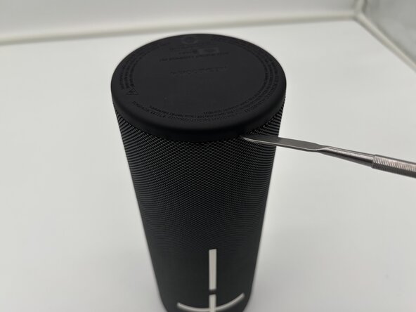

    • Flip your speaker upside down so the charging port side is faced upwards.
    • Place the end of a metal spudger in between the rubber bottom and the mesh case.
    • Work your way around the base of the speaker until the top separates from the case of the speaker.
    • This will take force.
    • Use the metal spudger carefully. Improper use may lead to injury.

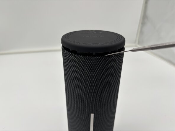

  2. Logitech UE Megaboom 4 Speaker Replacement: crwdns2935265:02crwdnd2935265:01crwdnd2935265:01crwdne2935265:0
    • Pull the bottom end of the speaker off and place it aside.
    • Once the glued seal is broken you will be able to pull it off with your hands.

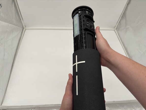

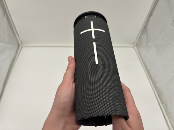

  3. Logitech UE Megaboom 4 Speaker Replacement: crwdns2935265:03crwdnd2935265:01crwdnd2935265:03crwdne2935265:0 Logitech UE Megaboom 4 Speaker Replacement: crwdns2935265:03crwdnd2935265:02crwdnd2935265:03crwdne2935265:0 Logitech UE Megaboom 4 Speaker Replacement: crwdns2935265:03crwdnd2935265:03crwdnd2935265:03crwdne2935265:0
    • Use your thumbs to press the two plastic tabs inside the speaker case and gently push out the internal components.
    • The inside components will begin to slide out of the top from the mesh casing.
  4. Logitech UE Megaboom 4 Speaker Replacement: crwdns2935265:04crwdnd2935265:01crwdnd2935265:01crwdne2935265:0
    • The internal components of the Logitech UE MegaBoom 4 speaker are now separated from the outer case.

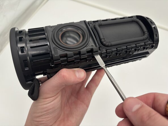

  5. Logitech UE Megaboom 4 Speaker Replacement, Speaker: crwdns2935265:05crwdnd2935265:01crwdnd2935265:02crwdne2935265:0 Logitech UE Megaboom 4 Speaker Replacement, Speaker: crwdns2935265:05crwdnd2935265:02crwdnd2935265:02crwdne2935265:0
    • Use a metal spudger or another suitable opening tool to push the metal rods on both sides of the speaker until they extend past the end of the device.
    • When the rods are pushed out far enough, use pliers to pull them out the rest of the way.
    • Repeat for each metal rod on the speaker.

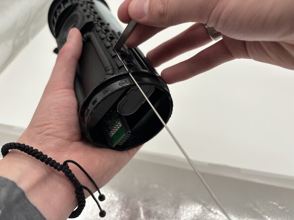

  6. Logitech UE Megaboom 4 Speaker Replacement: crwdns2935265:06crwdnd2935265:01crwdnd2935265:02crwdne2935265:0 Logitech UE Megaboom 4 Speaker Replacement: crwdns2935265:06crwdnd2935265:02crwdnd2935265:02crwdne2935265:0
    • Use a spudger to apply an upward force on the speaker plate.
    • Hold the speaker with one hand and use a spudger to pry the speaker off.
    • This will take some force.

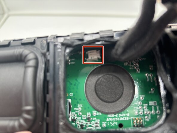

  7. Logitech UE Megaboom 4 Speaker Replacement: crwdns2935265:07crwdnd2935265:01crwdnd2935265:02crwdne2935265:0 Logitech UE Megaboom 4 Speaker Replacement: crwdns2935265:07crwdnd2935265:02crwdnd2935265:02crwdne2935265:0
    • Squeeze the end of the connector to release it from the socket and remove the speaker cables from the motherboard.
    • If you have difficulty removing the speaker connector, take a look at the Recognizing and Disconnecting Cable Connectors guide for additional help.
