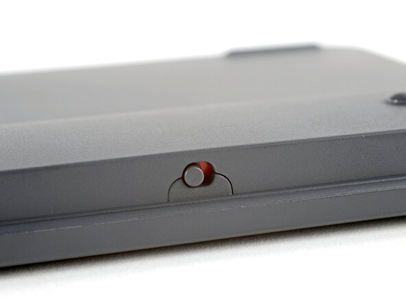

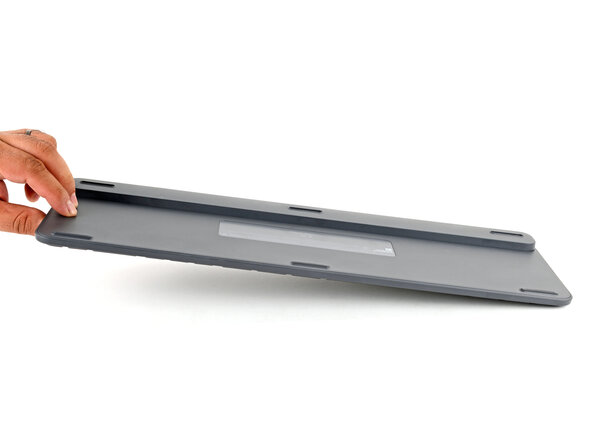

    • Slide the keyboard's power switch into the OFF position.
    • A red indicator should be visible beneath the switch.
    • Lay your keyboard down with the feet facing up on a clean work surface.
    • If your work surface may scratch the keyboard, place a soft towel under it.

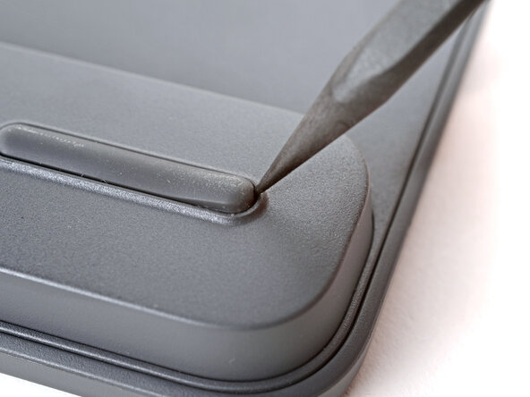

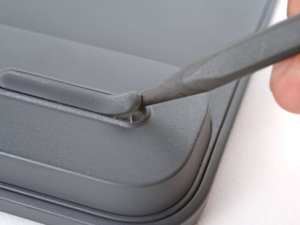

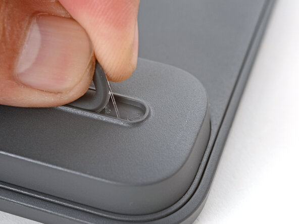

    • Insert the point of a spudger under an end of the foot.
    • Slide the spudger underneath the foot and lift until you can grip it with your fingers.

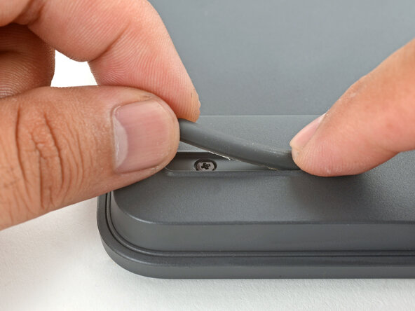

    • Peel the foot up and remove it.
  3. Logitech Signature Slim Solar+ Feet Replacement, Install a replacement foot: crwdns2935265:03crwdnd2935265:01crwdnd2935265:03crwdne2935265:0 Logitech Signature Slim Solar+ Feet Replacement, Install a replacement foot: crwdns2935265:03crwdnd2935265:02crwdnd2935265:03crwdne2935265:0 Logitech Signature Slim Solar+ Feet Replacement, Install a replacement foot: crwdns2935265:03crwdnd2935265:03crwdnd2935265:03crwdne2935265:0

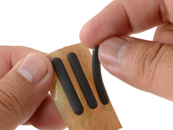

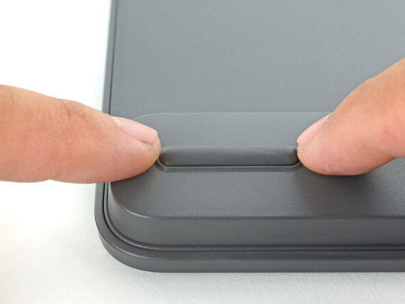

    • Remove a replacement foot from its backing and firmly press it into place.
