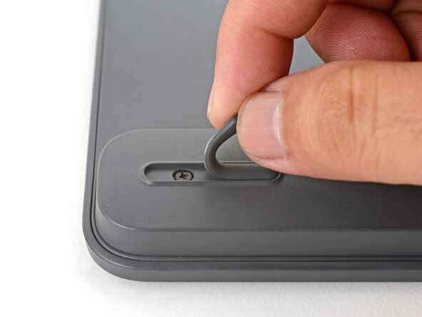

  2. Logitech Signature Slim Solar+ Battery Replacement, Remove the feet: crwdns2935265:02crwdnd2935265:01crwdnd2935265:03crwdne2935265:0 Logitech Signature Slim Solar+ Battery Replacement, Remove the feet: crwdns2935265:02crwdnd2935265:02crwdnd2935265:03crwdne2935265:0 Logitech Signature Slim Solar+ Battery Replacement, Remove the feet: crwdns2935265:02crwdnd2935265:03crwdnd2935265:03crwdne2935265:0
    • Insert the point of a spudger under an end of the foot.
    • Push the spudger underneath the foot and lift until you can grip it with your fingers.
    • Peel the foot up and remove it. Keep it for reassembly.

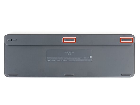

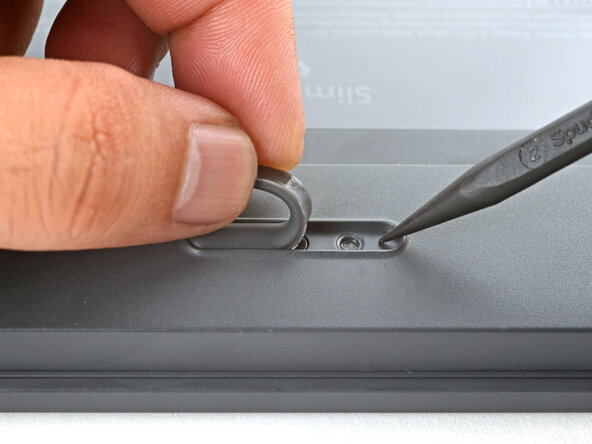

  3. Logitech Signature Slim Solar+ Battery Replacement, Remove the remaining top feet: crwdns2935265:03crwdnd2935265:01crwdnd2935265:03crwdne2935265:0 Logitech Signature Slim Solar+ Battery Replacement, Remove the remaining top feet: crwdns2935265:03crwdnd2935265:02crwdnd2935265:03crwdne2935265:0 Logitech Signature Slim Solar+ Battery Replacement, Remove the remaining top feet: crwdns2935265:03crwdnd2935265:03crwdnd2935265:03crwdne2935265:0
    • Repeat the procedure to remove two remaining feet along the top edge. Keep these for reassembly.

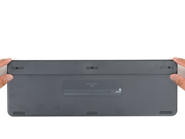

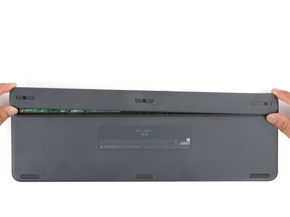

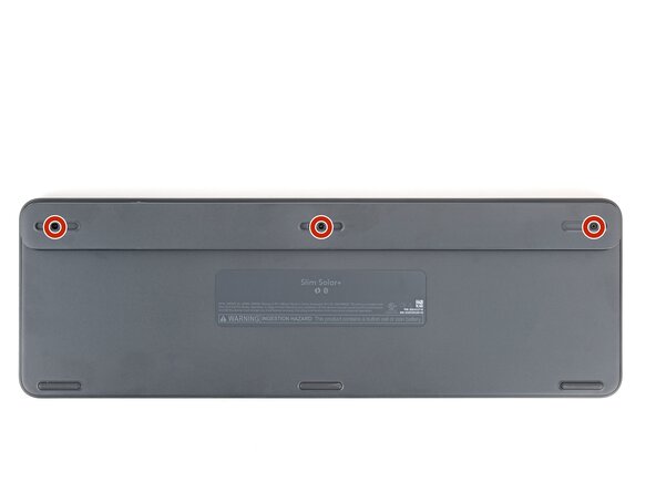

  4. Logitech Signature Slim Solar+ Battery Replacement, Remove the battery cover: crwdns2935265:04crwdnd2935265:01crwdnd2935265:01crwdne2935265:0
    • Use a Phillips screwdriver to loosen the three captive screws securing the battery cover.

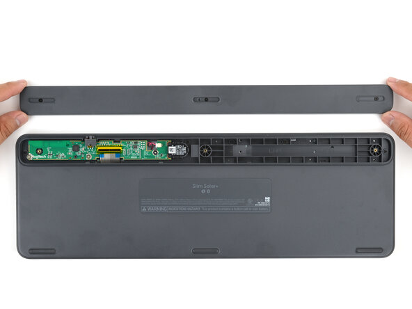

  5. Logitech Signature Slim Solar+ Battery Replacement: crwdns2935265:05crwdnd2935265:01crwdnd2935265:03crwdne2935265:0 Logitech Signature Slim Solar+ Battery Replacement: crwdns2935265:05crwdnd2935265:02crwdnd2935265:03crwdne2935265:0 Logitech Signature Slim Solar+ Battery Replacement: crwdns2935265:05crwdnd2935265:03crwdnd2935265:03crwdne2935265:0
    • Lift and remove the battery cover.

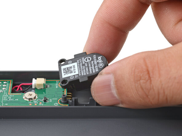

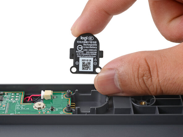

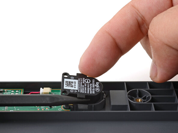

  6. Logitech Signature Slim Solar+ Battery Replacement: crwdns2935265:06crwdnd2935265:01crwdnd2935265:02crwdne2935265:0 Logitech Signature Slim Solar+ Battery Replacement: crwdns2935265:06crwdnd2935265:02crwdnd2935265:02crwdne2935265:0
    • Use your fingers or a spudger to lift and remove the battery by its side tabs.

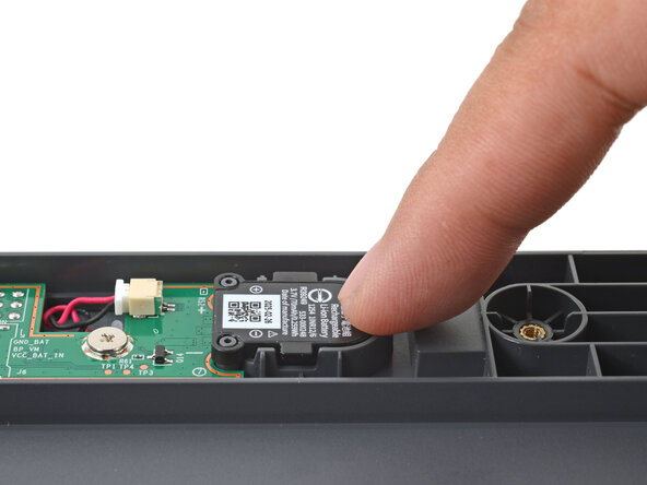

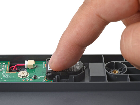

  7. Logitech Signature Slim Solar+ Battery Replacement, Install the replacement battery: crwdns2935265:07crwdnd2935265:01crwdnd2935265:03crwdne2935265:0 Logitech Signature Slim Solar+ Battery Replacement, Install the replacement battery: crwdns2935265:07crwdnd2935265:02crwdnd2935265:03crwdne2935265:0 Logitech Signature Slim Solar+ Battery Replacement, Install the replacement battery: crwdns2935265:07crwdnd2935265:03crwdnd2935265:03crwdne2935265:0
    • Align the battery with its recess and push down firmly with your finger to click it in place.
