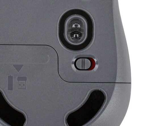

  1. Logitech Signature M650 Battery Replacement, Turn off your mouse: crwdns2935265:01crwdnd2935265:01crwdnd2935265:01crwdne2935265:0

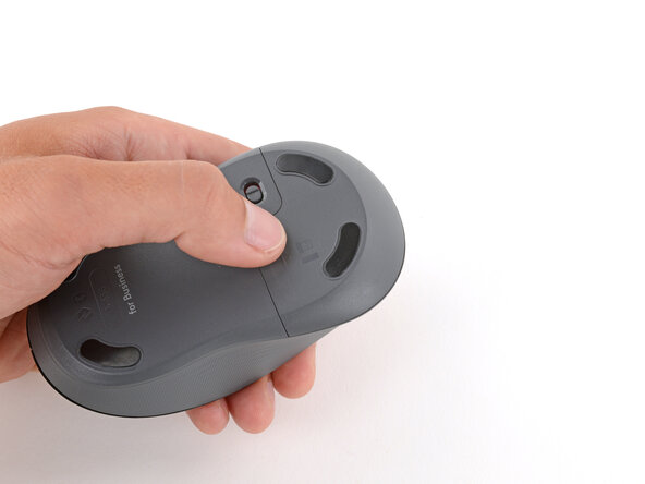

    • Before starting, flip the power switch on the bottom of your mouse to the left, so it's in the OFF position.

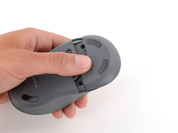

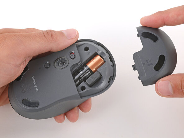

  2. Logitech Signature M650 Battery Replacement, Remove the battery cover: crwdns2935265:02crwdnd2935265:01crwdnd2935265:03crwdne2935265:0 Logitech Signature M650 Battery Replacement, Remove the battery cover: crwdns2935265:02crwdnd2935265:02crwdnd2935265:03crwdne2935265:0 Logitech Signature M650 Battery Replacement, Remove the battery cover: crwdns2935265:02crwdnd2935265:03crwdnd2935265:03crwdne2935265:0
    • Press down on the battery cover with your thumb and slide it away from the mouse to unclip it.
    • Remove the battery cover.

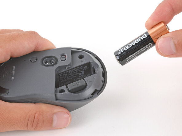

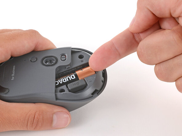

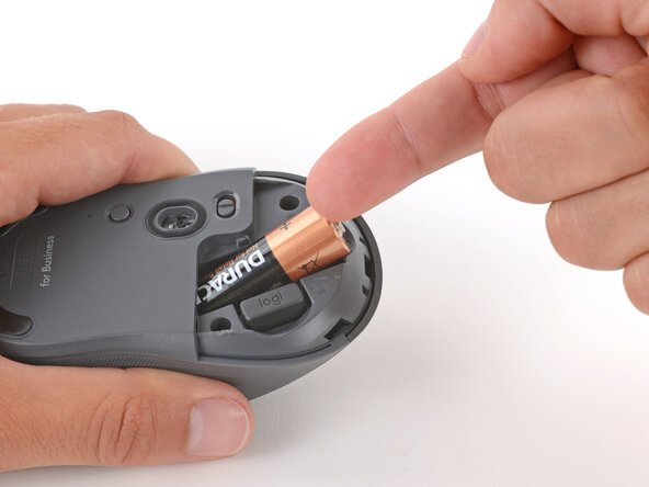

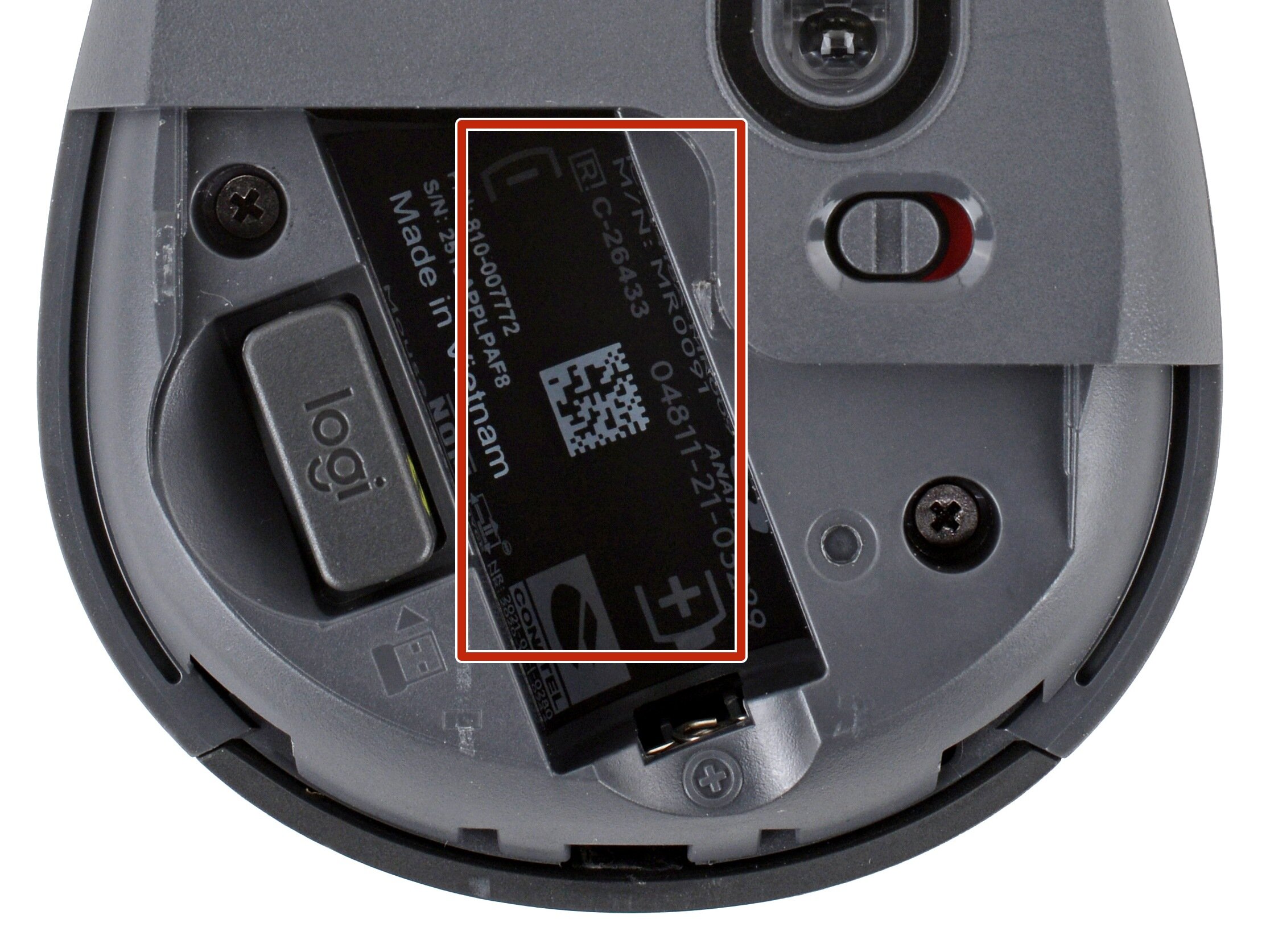

  3. Logitech Signature M650 Battery Replacement, Remove the battery: crwdns2935265:03crwdnd2935265:01crwdnd2935265:03crwdne2935265:0 Logitech Signature M650 Battery Replacement, Remove the battery: crwdns2935265:03crwdnd2935265:02crwdnd2935265:03crwdne2935265:0 Logitech Signature M650 Battery Replacement, Remove the battery: crwdns2935265:03crwdnd2935265:03crwdnd2935265:03crwdne2935265:0
    • Use your fingers to lift the end of the battery and slide it out of its recess.
    • During reassembly, slide the battery in negative (-) end first, as shown on the sticker in the recess.
