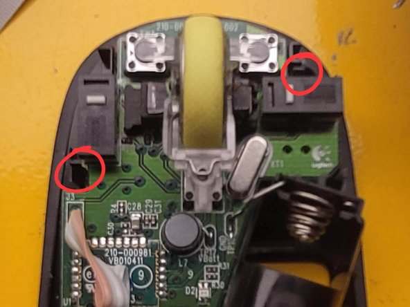

  2. Logitech M325c Mouse Buttons Replacement & Disassembly Guide, Housing disassembly: crwdns2935265:02crwdnd2935265:01crwdnd2935265:02crwdne2935265:0 Logitech M325c Mouse Buttons Replacement & Disassembly Guide, Housing disassembly: crwdns2935265:02crwdnd2935265:02crwdnd2935265:02crwdne2935265:0
    • Take the back cover and battery off
    • Use an exacto knife or just peel away the sticker to reveal the screw hole circled in the photo
    • Unscrew the screw
    • Use your fingernail or something similar to wedge the bottom of the housing apart
    • There will be resistance from the top part of the housing, as depicted in the second photo, there are four pieces from the top and bottom housing that hold onto each other.
    • Apply horizontal pressure and press from the mouse wheel to slide the top and bottom housing apart.
  3. Logitech M325c Mouse Buttons Replacement & Disassembly Guide, PCB disassembly: crwdns2935265:03crwdnd2935265:01crwdnd2935265:02crwdne2935265:0 Logitech M325c Mouse Buttons Replacement & Disassembly Guide, PCB disassembly: crwdns2935265:03crwdnd2935265:02crwdnd2935265:02crwdne2935265:0
    • You should now just have the PCB attached to the bottom housing.
    • There are two clips shown in the second photo that hold the PCB to the bottom housing
    • Use your fingernails or something similar to pry the clips away from the PCB.
    • After this step, the mouse wheel should detach from the PCB on its own.
    • The PCB may still be attached to the housing from the battery coil wires. Carefully remove them from the housing.

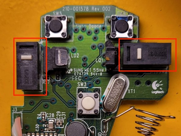

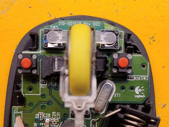

  4. Logitech M325c Mouse Buttons Replacement & Disassembly Guide, Desoldering switches and soldering: crwdns2935265:04crwdnd2935265:01crwdnd2935265:03crwdne2935265:0 Logitech M325c Mouse Buttons Replacement & Disassembly Guide, Desoldering switches and soldering: crwdns2935265:04crwdnd2935265:02crwdnd2935265:03crwdne2935265:0 Logitech M325c Mouse Buttons Replacement & Disassembly Guide, Desoldering switches and soldering: crwdns2935265:04crwdnd2935265:03crwdnd2935265:03crwdne2935265:0
    • At this stage, you should have the PCB separated from the housing.
    • Desolder the two mouse switches as labeled on the second photo.
    • As the Kailh Red Mute switches only have two legs, they use only the first two holes in the PCB.
    • The third photo shows the new switches soldered onto the PCB. The switches should be aligned as shown.
    • Solder the new switches onto the PCB
