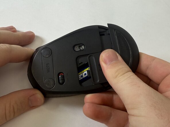

    • Flip the mouse over.
    • With your fingers, gently press down and remove the battery cover.

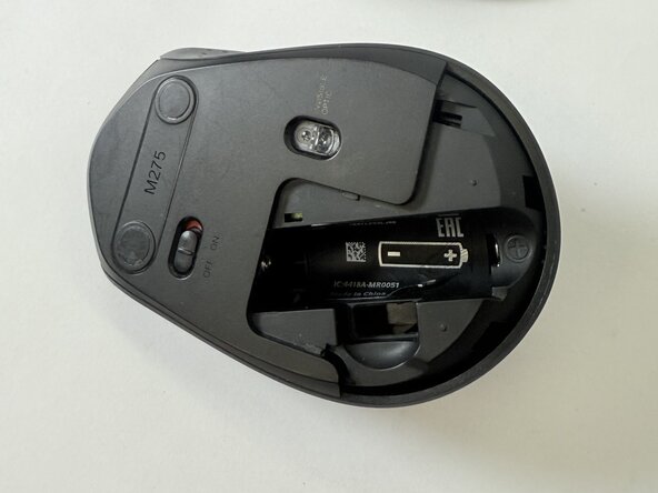

    • Remove the battery and the USB receiver from the mouse.

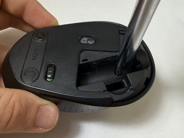

    • Remove the sticker at the bottom of the battery compartment.
    • Use a Phillips screwdriver to remove the single screws at the bottom of the battery compartment.

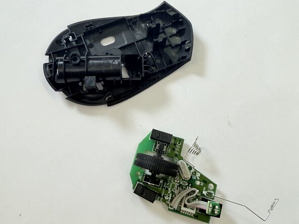

    • Carefully remove the top half of the mouse cover.

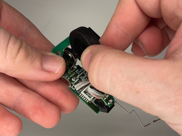

    • Use a spudger or screwdriver to carefully apply upward pressure around each side of the circuit board until the whole piece slides out of the bottom.

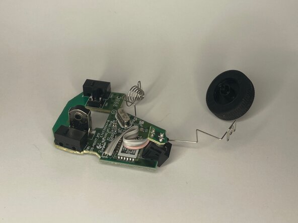

  5. Logitech M275 Scroll Wheel Replacement: crwdns2935265:05crwdnd2935265:01crwdnd2935265:01crwdne2935265:0
    • Using a soft cloth, gently remove dust and small debris.

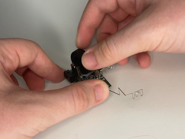

  6. Logitech M275 Scroll Wheel Replacement: crwdns2935265:06crwdnd2935265:01crwdnd2935265:03crwdne2935265:0 Logitech M275 Scroll Wheel Replacement: crwdns2935265:06crwdnd2935265:02crwdnd2935265:03crwdne2935265:0 Logitech M275 Scroll Wheel Replacement: crwdns2935265:06crwdnd2935265:03crwdnd2935265:03crwdne2935265:0

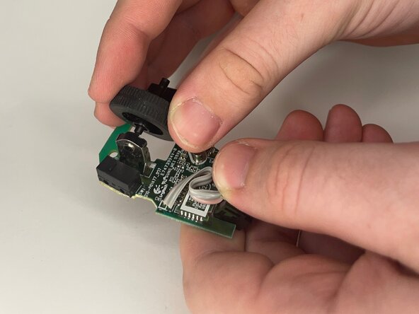

    • Carefully remove the wheel from its axis and replace it with the new wheel.
  7. Logitech M275 Scroll Wheel Replacement: crwdns2935265:07crwdnd2935265:01crwdnd2935265:03crwdne2935265:0 Logitech M275 Scroll Wheel Replacement: crwdns2935265:07crwdnd2935265:02crwdnd2935265:03crwdne2935265:0 Logitech M275 Scroll Wheel Replacement: crwdns2935265:07crwdnd2935265:03crwdnd2935265:03crwdne2935265:0
    • Ensure that the new scroll wheel is aligned with the encoder.
    • Make sure that the new scroll wheel spins and clicks into place.
