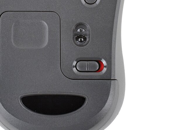

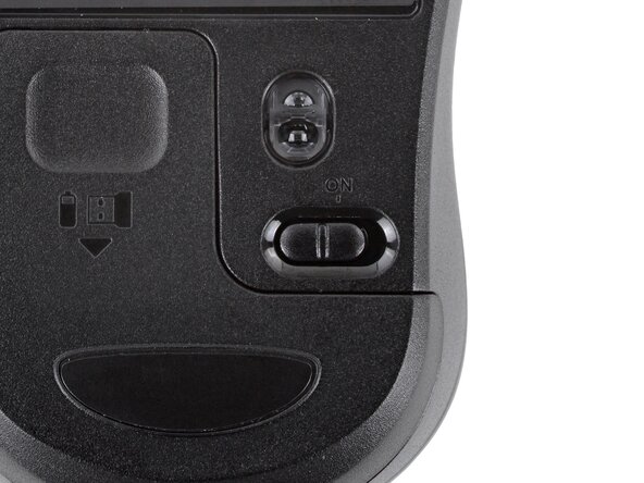

  1. Logitech M185 Battery Replacement, Turn off your mouse: crwdns2935265:01crwdnd2935265:01crwdnd2935265:01crwdne2935265:0
    • Before starting, flip the power switch on the bottom of your mouse to the left, so it's in the OFF position.

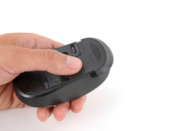

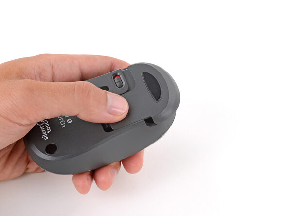

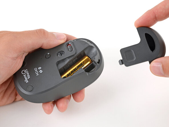

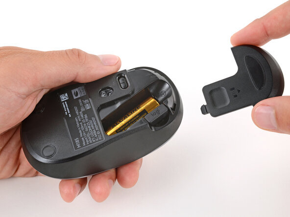

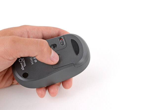

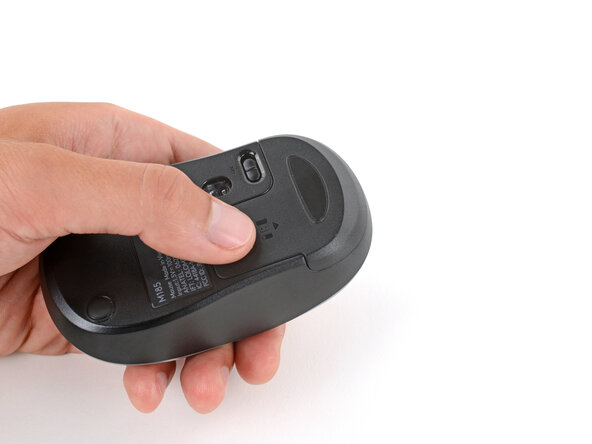

  2. Logitech M185 Battery Replacement, Remove the battery cover: crwdns2935265:02crwdnd2935265:01crwdnd2935265:03crwdne2935265:0 Logitech M185 Battery Replacement, Remove the battery cover: crwdns2935265:02crwdnd2935265:02crwdnd2935265:03crwdne2935265:0 Logitech M185 Battery Replacement, Remove the battery cover: crwdns2935265:02crwdnd2935265:03crwdnd2935265:03crwdne2935265:0
    • Press down on the battery cover with your thumb and slide it away from the mouse to unclip it.
    • Remove the battery cover.

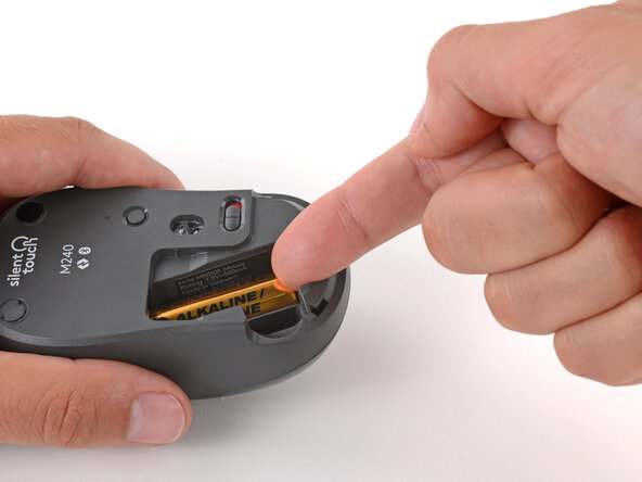

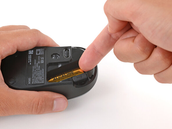

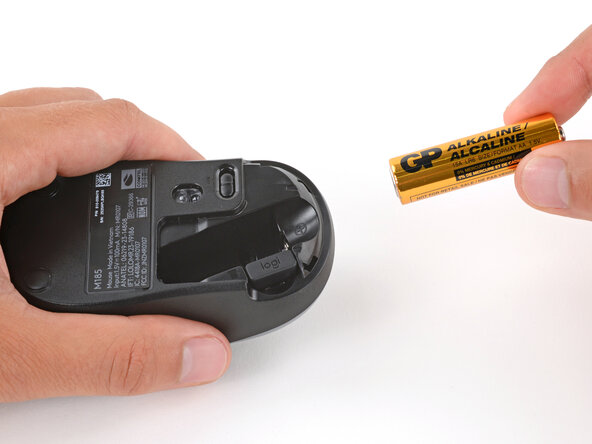

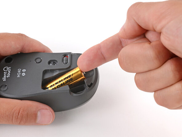

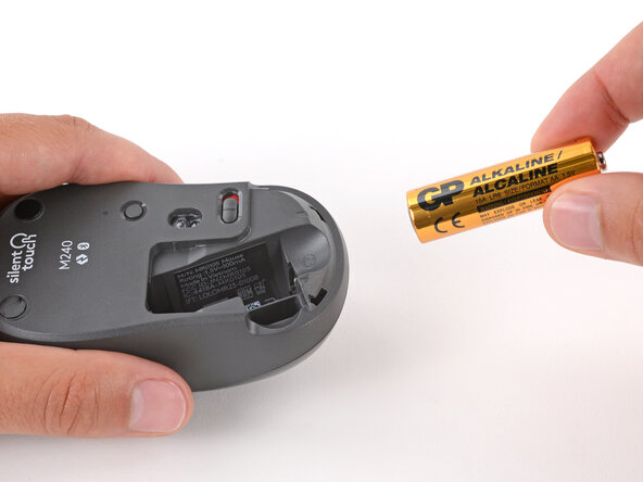

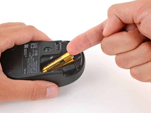

  3. Logitech M185 Battery Replacement, Remove the battery: crwdns2935265:03crwdnd2935265:01crwdnd2935265:03crwdne2935265:0 Logitech M185 Battery Replacement, Remove the battery: crwdns2935265:03crwdnd2935265:02crwdnd2935265:03crwdne2935265:0 Logitech M185 Battery Replacement, Remove the battery: crwdns2935265:03crwdnd2935265:03crwdnd2935265:03crwdne2935265:0
    • Use your fingers to lift the end of the battery and slide it out of its recess.
    • During reassembly, slide the battery in negative (-) end first, as shown in the recess.
