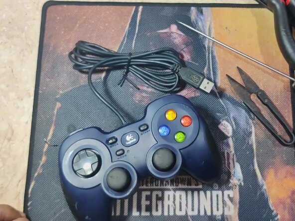

Logitech Gamepad F310 Cable Replacement

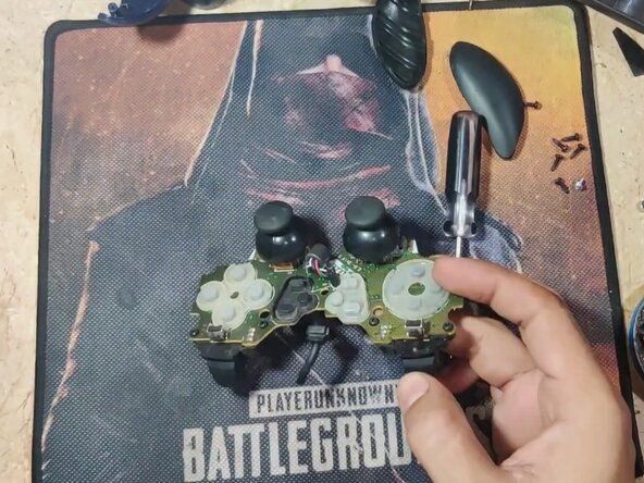

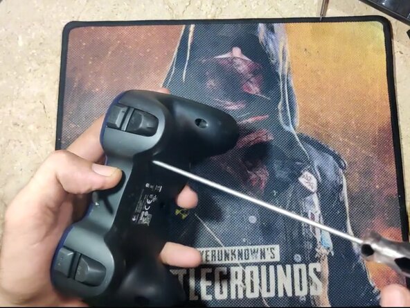

    • Turn the controller face-down on a soft surface.
    • Use a Phillips #1 screwdriver to remove the seven, 10 mm screws from the back shell.
    • Set the screws aside for reassembly.

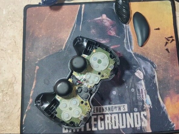

  2. Logitech Gamepad F310 Cable Replacement: crwdns2935265:02crwdnd2935265:01crwdnd2935265:02crwdne2935265:0 Logitech Gamepad F310 Cable Replacement: crwdns2935265:02crwdnd2935265:02crwdnd2935265:02crwdne2935265:0

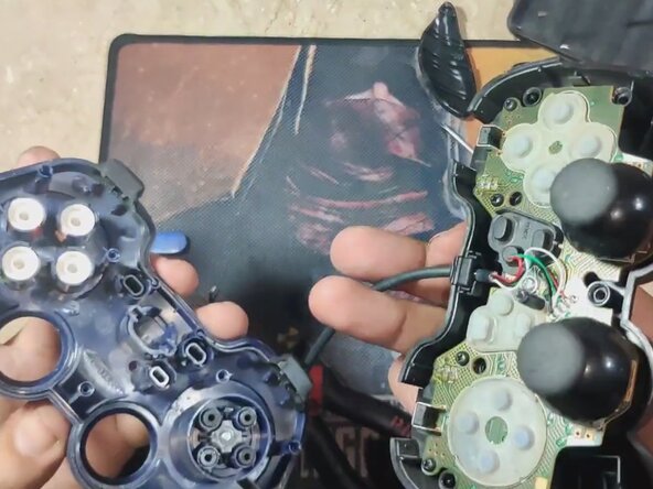

    • Use a plastic opening tool or spudger to release the clips holding the top and bottom of the controller together and separate the housing.
    • The face buttons, D-pad, and triggers are loose inside and may fall out when opening the controller.
    • Lift the back shell to expose the circuit board and cable.

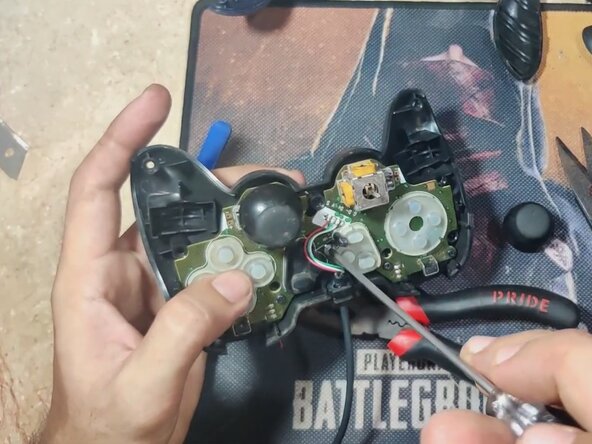

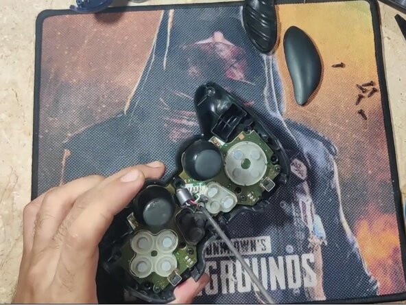

  3. Logitech Gamepad F310 Cable Replacement: crwdns2935265:03crwdnd2935265:01crwdnd2935265:03crwdne2935265:0 Logitech Gamepad F310 Cable Replacement: crwdns2935265:03crwdnd2935265:02crwdnd2935265:03crwdne2935265:0 Logitech Gamepad F310 Cable Replacement: crwdns2935265:03crwdnd2935265:03crwdnd2935265:03crwdne2935265:0
    • Use a Phillips #1 screwdriver to remove the single 6 mm screw securing the circuit board to the bottom shell.
    • Gently lift the circuit board from the rear shell to access the solder points for the USB cable.

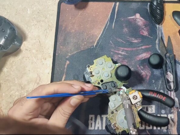

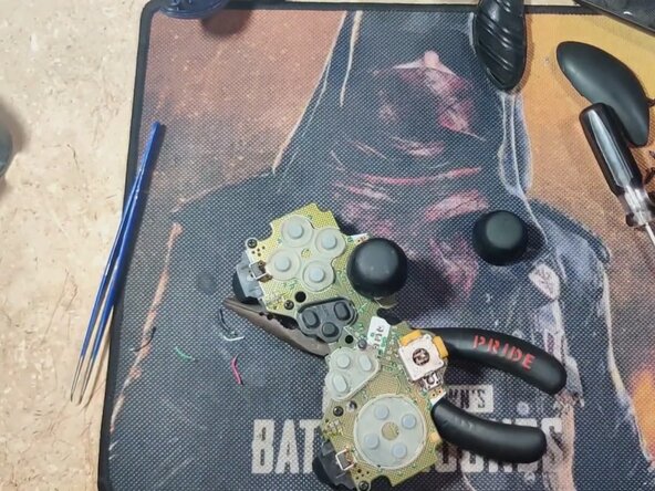

  4. Logitech Gamepad F310 Cable Replacement: crwdns2935265:04crwdnd2935265:01crwdnd2935265:03crwdne2935265:0 Logitech Gamepad F310 Cable Replacement: crwdns2935265:04crwdnd2935265:02crwdnd2935265:03crwdne2935265:0 Logitech Gamepad F310 Cable Replacement: crwdns2935265:04crwdnd2935265:03crwdnd2935265:03crwdne2935265:0
    • Cut the five wires to the damaged cable with a wire cutter first to make handling easier.
    • Use a soldering iron and wick or desoldering pumpto remove solder from each of the five pins.
    • Carefully remove each wire with tweezers once desoldered.
    • Be careful not to overheat the board or damage the pads during desoldering.

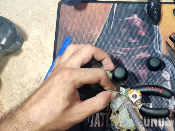

  5. Logitech Gamepad F310 Cable Replacement: crwdns2935265:05crwdnd2935265:01crwdnd2935265:03crwdne2935265:0 Logitech Gamepad F310 Cable Replacement: crwdns2935265:05crwdnd2935265:02crwdnd2935265:03crwdne2935265:0 Logitech Gamepad F310 Cable Replacement: crwdns2935265:05crwdnd2935265:03crwdnd2935265:03crwdne2935265:0
    • Use a wire stripper to strip the ends of the five wires on your replacement cable if it's not already done.
    • Tin the ends of each wire.
    • Match the wire colors to the board’s labeled pads (usually: VCC, D-, D+, GND, Shield).
    • Solder each wire carefully to its correct pad.
    • Double-check your solder joints to make sure there are no bridges or cold connections.

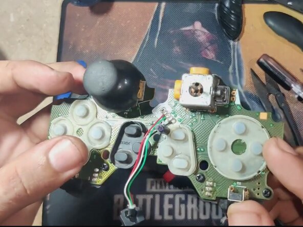

  6. Logitech Gamepad F310 Cable Replacement: crwdns2935265:06crwdnd2935265:01crwdnd2935265:03crwdne2935265:0 Logitech Gamepad F310 Cable Replacement: crwdns2935265:06crwdnd2935265:02crwdnd2935265:03crwdne2935265:0 Logitech Gamepad F310 Cable Replacement: crwdns2935265:06crwdnd2935265:03crwdnd2935265:03crwdne2935265:0
    • Route the new cable along the original path and ensure it sits flat in the groove.
    • Place the circuit board back into the back shell.
    • Use a Phillips #1 to replace the 6 mm screw.
    • Realign the buttons and membranes in the front shell if any were dislodged.
    • Snap the front and back halves together, ensuring nothing is pinched or out of place.
    • The face buttons, D-pad, and triggers are loose inside and may fall out when snapping the front and back halves of the controller together. Attach the back shell to the front shell and not vice versa.
  7. Logitech Gamepad F310 Cable Replacement: crwdns2935265:07crwdnd2935265:01crwdnd2935265:02crwdne2935265:0 Logitech Gamepad F310 Cable Replacement: crwdns2935265:07crwdnd2935265:02crwdnd2935265:02crwdne2935265:0
    • Replace the seven 10 mm-long PH1 screws.
    • Tighten the screws evenly, but avoid overtightening them—you could strip the threads or break the screw heads.
    • Plug the controller into your computer and test all buttons, triggers, and joysticks to confirm everything works.
