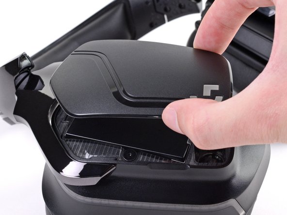

  2. Logitech G935 Battery Replacement, Lift the ear cup door: crwdns2935265:02crwdnd2935265:01crwdnd2935265:02crwdne2935265:0 Logitech G935 Battery Replacement, Lift the ear cup door: crwdns2935265:02crwdnd2935265:02crwdnd2935265:02crwdne2935265:0
    • Two magnets secure the ear cup door to the headset—one on the left side and one on the bottom.
    • A clip on the top right of the ear cup door also secures it to the headset.
    • Use the indent on the right ear cup door to lift and detach the magnets from the headset.
  3. Logitech G935 Battery Replacement, Remove the ear cup door: crwdns2935265:03crwdnd2935265:01crwdnd2935265:02crwdne2935265:0 Logitech G935 Battery Replacement, Remove the ear cup door: crwdns2935265:03crwdnd2935265:02crwdnd2935265:02crwdne2935265:0
    • Lift and remove the right ear cup door.
    • During reassembly, insert the clip into its slot before placing the magnets down so that the door is properly aligned.
