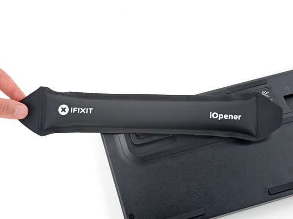

    • Heat an iOpener and lay it on one of the feet for one minute.
    • Alternatively, you can use a hair dryer on the Low heat setting to soften the adhesive.
    • If you're using a hair dryer, only heat the feet a few seconds at a time or you may warp the plastic body.

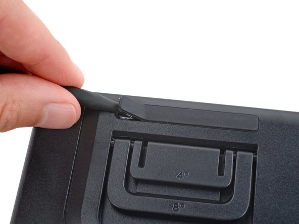

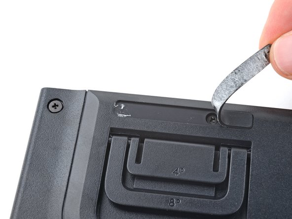

    • Insert the point of a spudger under an end of the foot.
    • Push the spudger underneath the foot and lift until you can grip it with your fingers.

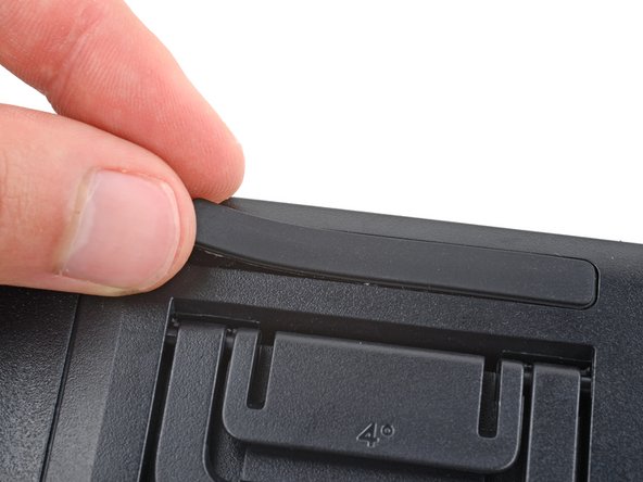

    • The foot should come up without much force. If it feels stuck, apply more heat and try again.
    • Peel the foot up and remove it.
    • Repeat the previous two steps to remove the remaining feet.
