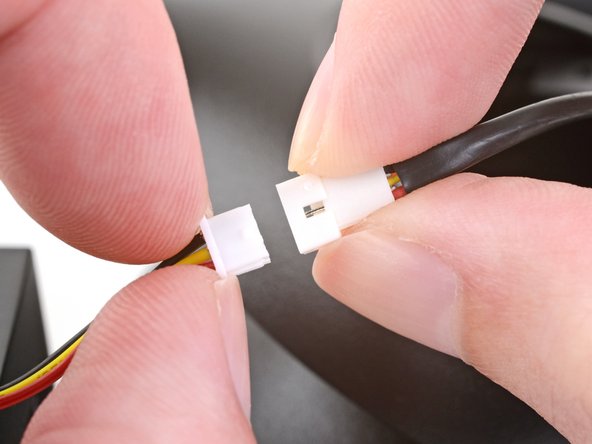

  8. Logitech G533 Battery Replacement: crwdns2935265:08crwdnd2935265:01crwdnd2935265:02crwdne2935265:0 Logitech G533 Battery Replacement: crwdns2935265:08crwdnd2935265:02crwdnd2935265:02crwdne2935265:0
    • While holding the battery connector socket, pull the battery connector out.
    • Hold the battery connector socket and battery connector by their plastic frames and not by their cables to prevent damaging them.
    • If necessary, pull the battery connector with a rocking motion to "walk" it out of its socket.
    • You may need to use your fingernails to pull the battery connector out by the shelf near the cables.
    • When inserting the battery connector, make sure it is oriented correctly. The red cable on the battery connector should line up with the red cable on the battery socket.
  9. Logitech G533 Battery Replacement: crwdns2935265:09crwdnd2935265:01crwdnd2935265:01crwdne2935265:0
    • Remove the battery from the headset.
    • This headset has a plastic reinforced battery pack. You can reinstall the original battery if needed.
