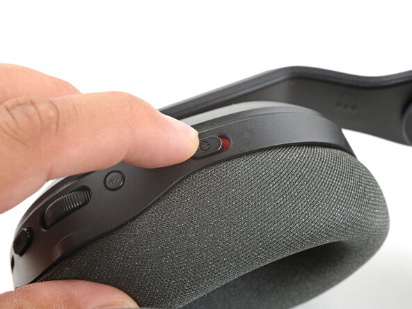

  1. Logitech G522 Lightspeed Battery Replacement, Prepare the headset for disassembly: crwdns2935265:01crwdnd2935265:01crwdnd2935265:02crwdne2935265:0 Logitech G522 Lightspeed Battery Replacement, Prepare the headset for disassembly: crwdns2935265:01crwdnd2935265:02crwdnd2935265:02crwdne2935265:0
    • Power off the headset and unplug all cables.

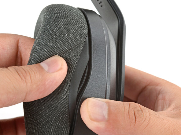

  2. Logitech G522 Lightspeed Battery Replacement, Remove the right ear pad: crwdns2935265:02crwdnd2935265:01crwdnd2935265:03crwdne2935265:0 Logitech G522 Lightspeed Battery Replacement, Remove the right ear pad: crwdns2935265:02crwdnd2935265:02crwdnd2935265:03crwdne2935265:0 Logitech G522 Lightspeed Battery Replacement, Remove the right ear pad: crwdns2935265:02crwdnd2935265:03crwdnd2935265:03crwdne2935265:0
    • With one hand, firmly hold the right ear cup steady.
    • With your free hand, slowly pull the ear pad away from the cup until it slides completely off its plastic lip.
    • Remove the ear cup and set it aside for reassembly.

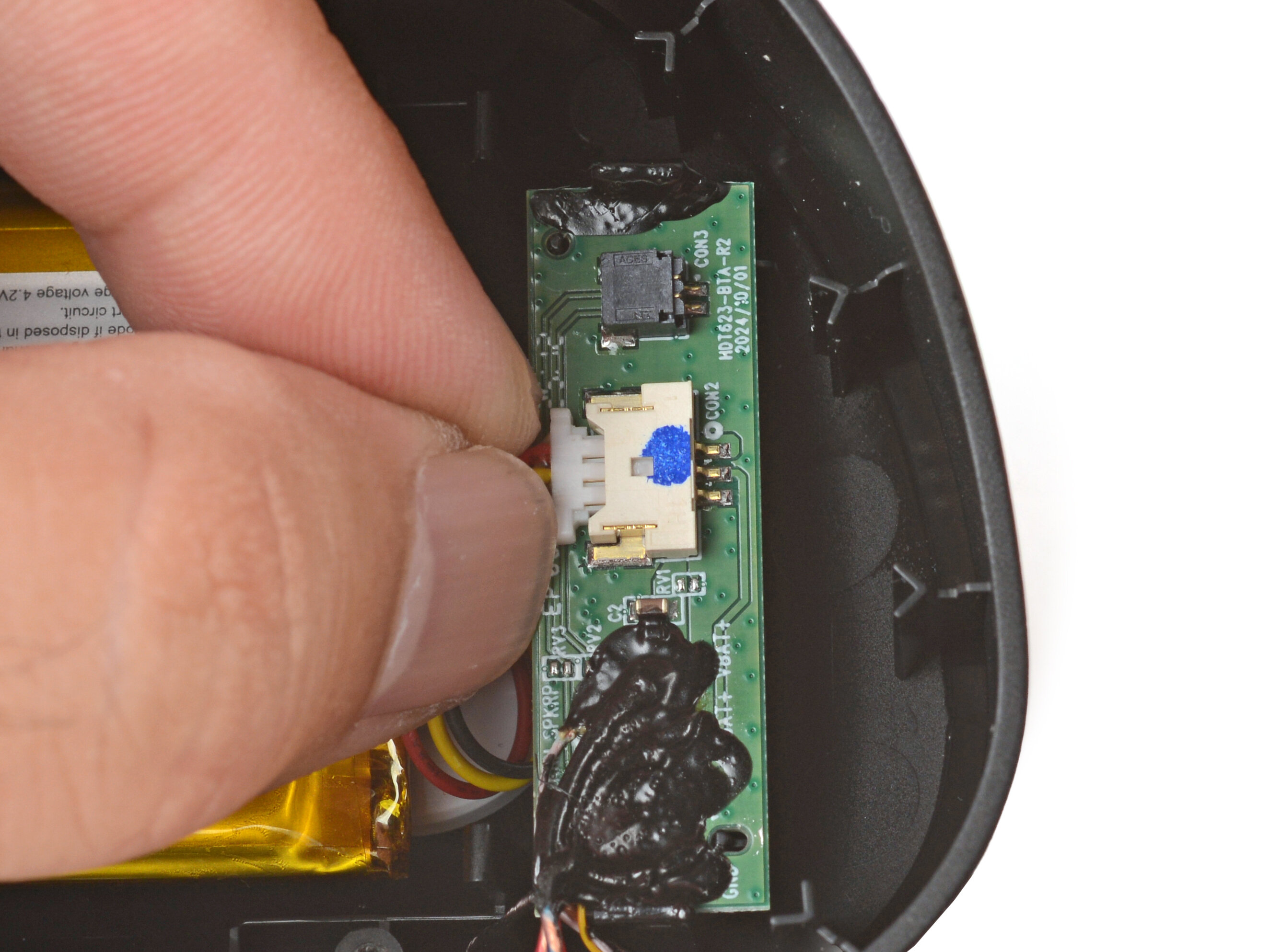

  10. Logitech G522 Lightspeed Battery Replacement, Disconnect the battery: crwdns2935265:010crwdnd2935265:01crwdnd2935265:03crwdne2935265:0 Logitech G522 Lightspeed Battery Replacement, Disconnect the battery: crwdns2935265:010crwdnd2935265:02crwdnd2935265:03crwdne2935265:0 Logitech G522 Lightspeed Battery Replacement, Disconnect the battery: crwdns2935265:010crwdnd2935265:03crwdnd2935265:03crwdne2935265:0
    • Use your fingernails to grip the edges of the battery connector and slide it out of its socket.
    • You can also use a pair of angled tweezers, but be very careful not to puncture the battery or touch the three metal contacts on the connector.
    • If you're having trouble, try rocking the connector side-to-side to help loosen it.
    • During reassembly, align the connector (it connects in only one orientation) and use your finger to gently push it into its socket. You should feel a faint click when it's fully seated.
