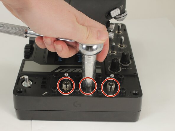

  5. Logitech G X56 HOTAS Throttle Switch Board Replacement, Switch Board: crwdns2935265:05crwdnd2935265:01crwdnd2935265:02crwdne2935265:0 Logitech G X56 HOTAS Throttle Switch Board Replacement, Switch Board: crwdns2935265:05crwdnd2935265:02crwdnd2935265:02crwdne2935265:0
    • Remove the 14 mm nuts at the base of the switches.
