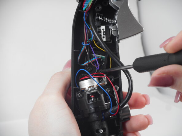

  3. Logitech G X56 HOTAS Joystick Mini Analog Joystick Cover Replacement: crwdns2935265:03crwdnd2935265:01crwdnd2935265:02crwdne2935265:0 Logitech G X56 HOTAS Joystick Mini Analog Joystick Cover Replacement: crwdns2935265:03crwdnd2935265:02crwdnd2935265:02crwdne2935265:0
    • Pull the joystick casing apart to reveal the internal components.
    • The casing will need a little force to split open.
    • Take care not to damage or strain the connected cable.

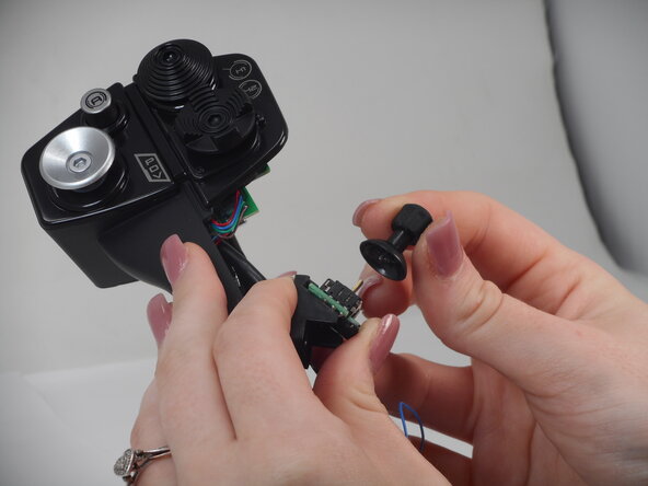

  6. Logitech G X56 HOTAS Joystick Mini Analog Joystick Cover Replacement, Mini Analog Joystick Cover: crwdns2935265:06crwdnd2935265:01crwdnd2935265:02crwdne2935265:0 Logitech G X56 HOTAS Joystick Mini Analog Joystick Cover Replacement, Mini Analog Joystick Cover: crwdns2935265:06crwdnd2935265:02crwdnd2935265:02crwdne2935265:0
    • Remove the two Phillips #0 11.7 mm screws that secure the mini analog stick PCB.

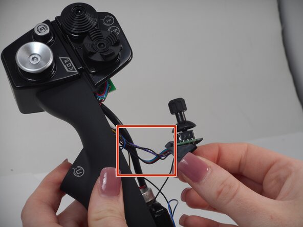

  7. Logitech G X56 HOTAS Joystick Mini Analog Joystick Cover Replacement: crwdns2935265:07crwdnd2935265:01crwdnd2935265:02crwdne2935265:0 Logitech G X56 HOTAS Joystick Mini Analog Joystick Cover Replacement: crwdns2935265:07crwdnd2935265:02crwdnd2935265:02crwdne2935265:0
    • Gently lift the housing containing the PCB and the joystick from the housing.
    • Carefully remove the housing, since the wires are connected to the PCBs in the joystick.
  8. Logitech G X56 HOTAS Joystick Mini Analog Joystick Cover Replacement: crwdns2935265:08crwdnd2935265:01crwdnd2935265:02crwdne2935265:0 Logitech G X56 HOTAS Joystick Mini Analog Joystick Cover Replacement: crwdns2935265:08crwdnd2935265:02crwdnd2935265:02crwdne2935265:0
    • Using two fingers, pull the mini joystick cover directly off.
