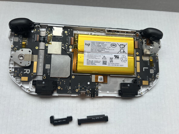

    • Power the device off and turn it over so the screen is face down.
    • Insert an opening pick into the seam between the back plate and left handguard.
    • Pry around the entire perimeter until the handguard fully releases.
    • Remove the handguard.
    • Repeat the previous three bullets on the right handguard.
  2. Logitech G Cloud Wi-Fi Chip Replacement: crwdns2935265:02crwdnd2935265:01crwdnd2935265:01crwdne2935265:0
    • Use a Phillips #00 screwdriver to remove all eight 10 mm screws from the rear case located under where the handguards were.
  3. Logitech G Cloud Wi-Fi Chip Replacement: crwdns2935265:03crwdnd2935265:01crwdnd2935265:02crwdne2935265:0 Logitech G Cloud Wi-Fi Chip Replacement: crwdns2935265:03crwdnd2935265:02crwdnd2935265:02crwdne2935265:0
    • Insert an opening pick into the seam between the midframe and rear case.
    • Gently pry the rear case upwards to separate it from the midframe.
  4. Logitech G Cloud Wi-Fi Chip Replacement: crwdns2935265:04crwdnd2935265:01crwdnd2935265:01crwdne2935265:0
    • Use a Phillips #00 screwdriver to remove all seven 10 mm screws that secure the midframe.
  5. Logitech G Cloud Wi-Fi Chip Replacement: crwdns2935265:05crwdnd2935265:01crwdnd2935265:02crwdne2935265:0 Logitech G Cloud Wi-Fi Chip Replacement: crwdns2935265:05crwdnd2935265:02crwdnd2935265:02crwdne2935265:0
    • Insert an opening pick into the seam between the midframe and front case at the top of the device to separate the interior plating.
    • Gently pry out the midframe by lifting an opening pick.
    • You may hear loud popping noises when you remove the interior plating. That's the sound of the retaining clips disengaging.
  6. Logitech G Cloud Wi-Fi Chip Replacement, Wi-Fi Chip: crwdns2935265:06crwdnd2935265:01crwdnd2935265:02crwdne2935265:0 Logitech G Cloud Wi-Fi Chip Replacement, Wi-Fi Chip: crwdns2935265:06crwdnd2935265:02crwdnd2935265:02crwdne2935265:0
    • Use a Phillips #00 screwdriver to remove all four 10 mm screws that secure the Wi-Fi chips located on the top and bottom of the device.
    • Pop the Wi-Fi chips out with your fingers.
