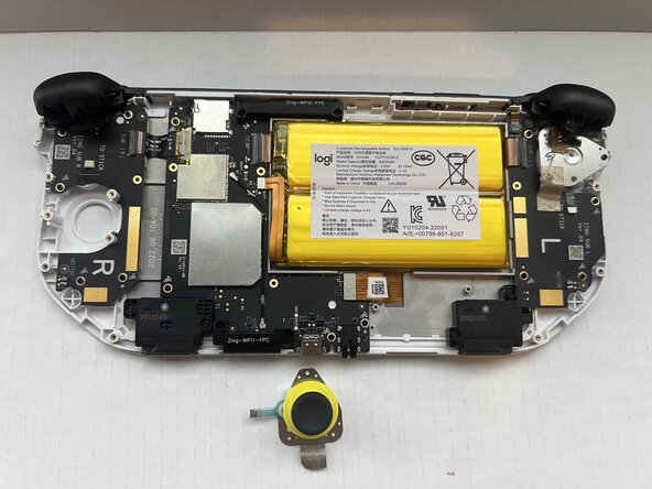

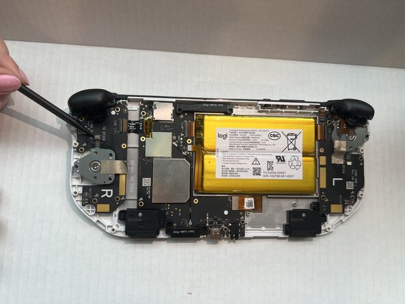

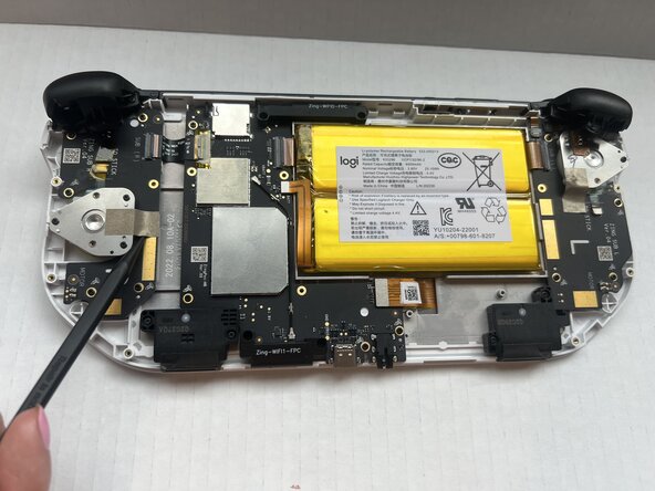

  6. Logitech G Cloud Right Joystick Replacement, Right Joystick: crwdns2935265:06crwdnd2935265:01crwdnd2935265:03crwdne2935265:0 Logitech G Cloud Right Joystick Replacement, Right Joystick: crwdns2935265:06crwdnd2935265:02crwdnd2935265:03crwdne2935265:0 Logitech G Cloud Right Joystick Replacement, Right Joystick: crwdns2935265:06crwdnd2935265:03crwdnd2935265:03crwdne2935265:0
    • Use a spudger to lift upwards and disconnect the metallic sticker from the console.
    • The sticker should stay attached to the joystick plate.
    • Insert the flat end of a spudger under the joystick press connector and lift upwards to disconnect it.
    • Use a spudger to remove the R2 trigger sensor from the joystick plate; it should stay attached to the console.
  7. Logitech G Cloud Right Joystick Replacement: crwdns2935265:07crwdnd2935265:01crwdnd2935265:02crwdne2935265:0 Logitech G Cloud Right Joystick Replacement: crwdns2935265:07crwdnd2935265:02crwdnd2935265:02crwdne2935265:0
    • Use a Phillips #00 screwdriver to remove all three 10 mm screws that secure the joystick assembly.
    • Pop the joystick out with your fingers.
