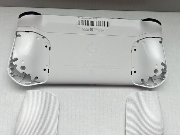

    • Power the device off and turn it over so the screen is face down.
    • Insert an opening pick into the seam between the back plate and left handguard.
    • Pry around the entire perimeter until the handguard fully releases.
    • Remove the handguard.
    • Repeat the previous three bullets on the right handguard.

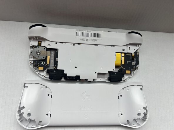

  3. Logitech G Cloud Battery Replacement: crwdns2935265:03crwdnd2935265:01crwdnd2935265:02crwdne2935265:0 Logitech G Cloud Battery Replacement: crwdns2935265:03crwdnd2935265:02crwdnd2935265:02crwdne2935265:0
    • Insert an opening pick into the seam between the midframe and rear case.
    • Gently pry the rear case upwards to separate it from the midframe.

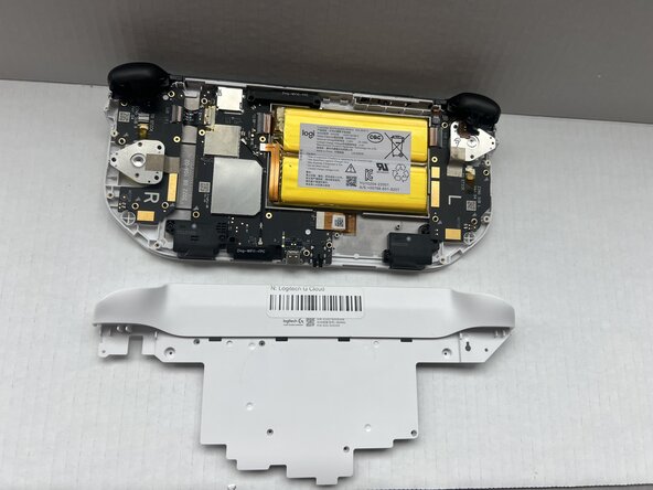

  4. Logitech G Cloud Battery Replacement: crwdns2935265:04crwdnd2935265:01crwdnd2935265:01crwdne2935265:0
    • Use a Phillips #00 screwdriver to remove all seven 10 mm screws that secure the midframe.
  5. Logitech G Cloud Battery Replacement: crwdns2935265:05crwdnd2935265:01crwdnd2935265:02crwdne2935265:0 Logitech G Cloud Battery Replacement: crwdns2935265:05crwdnd2935265:02crwdnd2935265:02crwdne2935265:0
    • Insert an opening pick into the seam between the midframe and front case at the top of the device to separate the interior plating.
    • Gently pry out the midframe by lifting an opening pick.
    • You may hear loud popping noises when you remove the interior plating. That's the sound of the retaining clips disengaging.

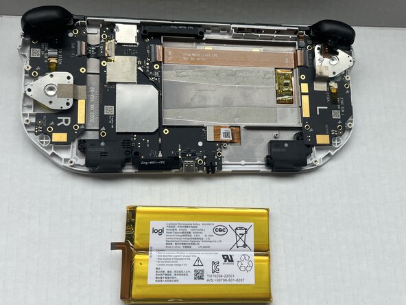

  6. Logitech G Cloud Battery Replacement, Battery: crwdns2935265:06crwdnd2935265:01crwdnd2935265:03crwdne2935265:0 Logitech G Cloud Battery Replacement, Battery: crwdns2935265:06crwdnd2935265:02crwdnd2935265:03crwdne2935265:0 Logitech G Cloud Battery Replacement, Battery: crwdns2935265:06crwdnd2935265:03crwdnd2935265:03crwdne2935265:0
    Tesa 61395 Tape
    $5.99

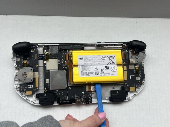

    • Insert the flat end of a spudger under the edge of the battery press connector and lift straight up to disconnect it.
    • Insert an opening tool under the bottom edge of the battery. Gently and slowly lift straight up to separate the adhesive on the battery from the console.
    • Take care not to bend, warp, or puncture the battery.
    • If your replacement battery doesn't come with adhesive, use a strong double-sided adhesive to secure it.
For optimal performance, after completing this guide, calibrate your newly installed battery.
