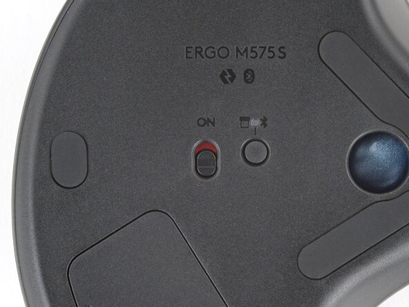

  1. Logitech Ergo M575S Battery Replacement, Turn off your mouse: crwdns2935265:01crwdnd2935265:01crwdnd2935265:01crwdne2935265:0
    • Before starting, flip the power switch on the bottom of your mouse down, so it's in the OFF position.

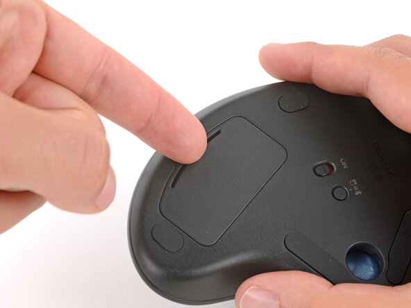

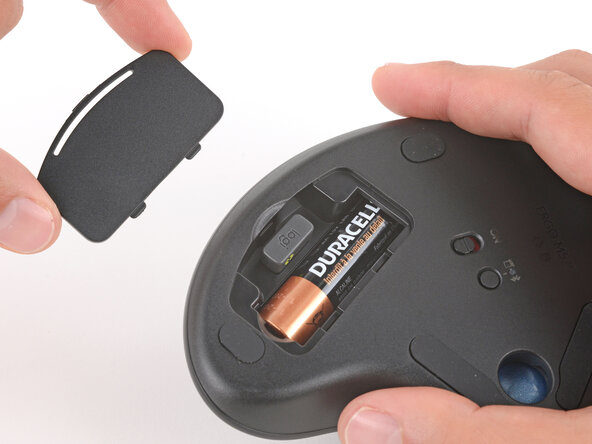

  2. Logitech Ergo M575S Battery Replacement, Remove the battery cover: crwdns2935265:02crwdnd2935265:01crwdnd2935265:03crwdne2935265:0 Logitech Ergo M575S Battery Replacement, Remove the battery cover: crwdns2935265:02crwdnd2935265:02crwdnd2935265:03crwdne2935265:0 Logitech Ergo M575S Battery Replacement, Remove the battery cover: crwdns2935265:02crwdnd2935265:03crwdnd2935265:03crwdne2935265:0
    • Push the battery cover's center tab in and up to remove the cover.

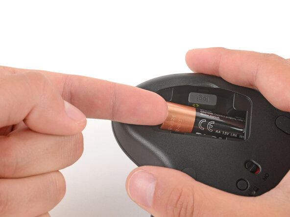

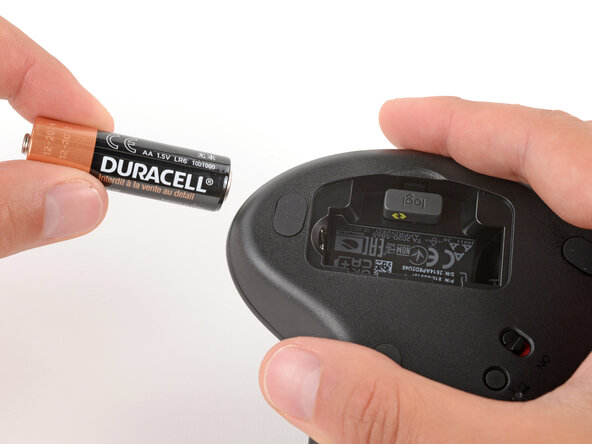

  3. Logitech Ergo M575S Battery Replacement, Remove the battery: crwdns2935265:03crwdnd2935265:01crwdnd2935265:03crwdne2935265:0 Logitech Ergo M575S Battery Replacement, Remove the battery: crwdns2935265:03crwdnd2935265:02crwdnd2935265:03crwdne2935265:0 Logitech Ergo M575S Battery Replacement, Remove the battery: crwdns2935265:03crwdnd2935265:03crwdnd2935265:03crwdne2935265:0
    • Use your fingers to lift the end of the battery and slide it out of its recess.
    • During reassembly, check the sticker in the recess to ensure you insert the battery in the proper orientation.
