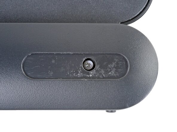

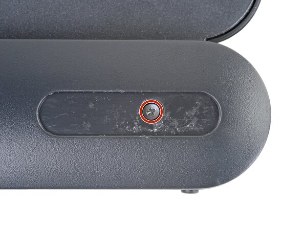

  4. Logitech Craft Battery Replacement, Remove the screw securing the bottom cover: crwdns2935265:04crwdnd2935265:01crwdnd2935265:02crwdne2935265:0 Logitech Craft Battery Replacement, Remove the screw securing the bottom cover: crwdns2935265:04crwdnd2935265:02crwdnd2935265:02crwdne2935265:0
    • If there's plastic film covering the screw, use the point of a spudger to poke through it.
    • Use a Phillips screwdriver to remove the 4.7 mm‑long screw securing the bottom cover.

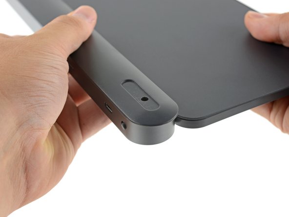

  5. Logitech Craft Battery Replacement, Unlock the bottom cover: crwdns2935265:05crwdnd2935265:01crwdnd2935265:02crwdne2935265:0 Logitech Craft Battery Replacement, Unlock the bottom cover: crwdns2935265:05crwdnd2935265:02crwdnd2935265:02crwdne2935265:0
    • The bottom cover is held in place by slotted plastic clips along the entire length of the keyboard.
    • Don't attempt to force the cover off until all clips have disengaged. The bottom cover should come away with little to no force.
    • Hold the keyboard upside down above your work surface.
    • Grip the bottom cover and slide it towards the ON/OFF switch to unlock it from the rest of the device.

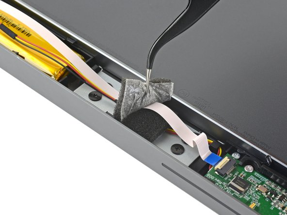

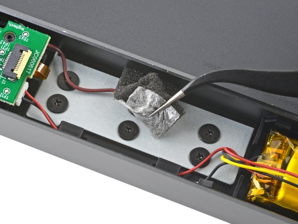

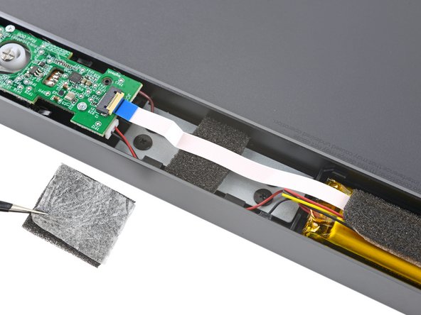

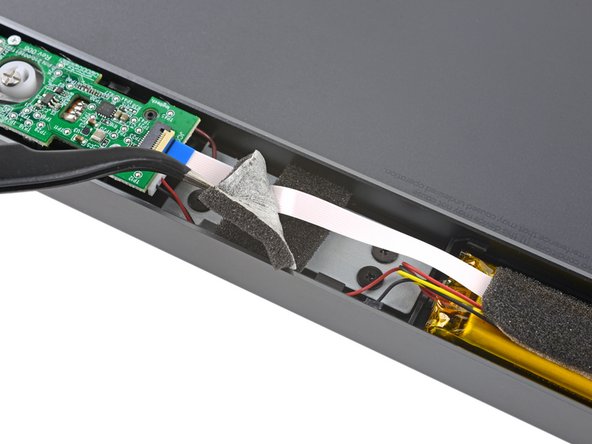

  7. Logitech Craft Battery Replacement, Remove the foam pieces: crwdns2935265:07crwdnd2935265:01crwdnd2935265:03crwdne2935265:0 Logitech Craft Battery Replacement, Remove the foam pieces: crwdns2935265:07crwdnd2935265:02crwdnd2935265:03crwdne2935265:0 Logitech Craft Battery Replacement, Remove the foam pieces: crwdns2935265:07crwdnd2935265:03crwdnd2935265:03crwdne2935265:0
    • Various pieces of foam protect the battery wires and the interconnect ribbon cable. They'll need to be removed in order to access the battery.
    • Use a pair of tweezers to peel up and remove the first piece of foam covering the interconnect cable.
    • The foam pads are all secured with light adhesive.
    • Try your best to not rip these foam pads as you remove them—ideally they're reused during reassembly.

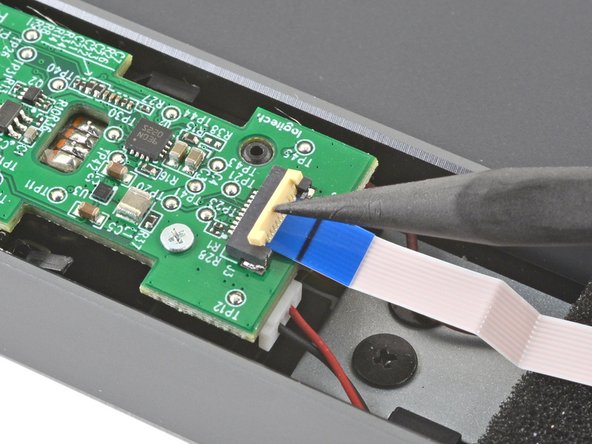

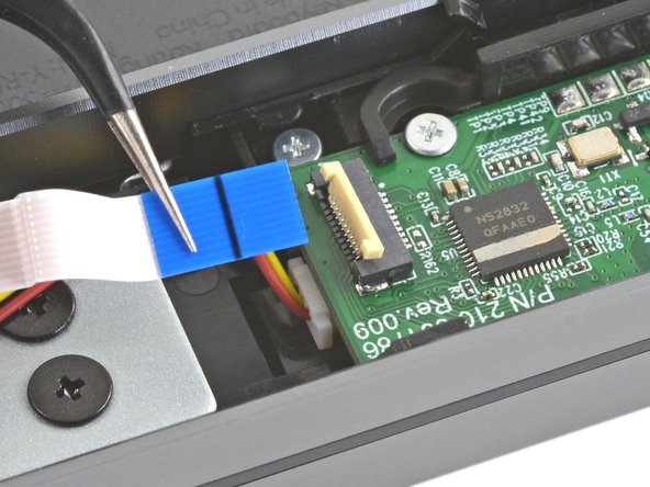

  9. Logitech Craft Battery Replacement, Remove the interconnect cable: crwdns2935265:09crwdnd2935265:01crwdnd2935265:03crwdne2935265:0 Logitech Craft Battery Replacement, Remove the interconnect cable: crwdns2935265:09crwdnd2935265:02crwdnd2935265:03crwdne2935265:0 Logitech Craft Battery Replacement, Remove the interconnect cable: crwdns2935265:09crwdnd2935265:03crwdnd2935265:03crwdne2935265:0
    • Use the point of a spudger to gently lift the hinged locking flap on the interconnect cable's ZIF connector up and away from the cable.
    • Use a pair of tweezers to slide the interconnect cable out of its connector.
    • Try to grip the cable by the blue plastic, not by the cable itself.

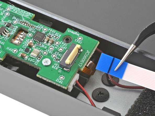

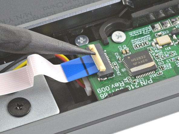

  10. Logitech Craft Battery Replacement: crwdns2935265:010crwdnd2935265:01crwdnd2935265:03crwdne2935265:0 Logitech Craft Battery Replacement: crwdns2935265:010crwdnd2935265:02crwdnd2935265:03crwdne2935265:0 Logitech Craft Battery Replacement: crwdns2935265:010crwdnd2935265:03crwdnd2935265:03crwdne2935265:0
    • Use the point of a spudger to lift the hinged locking flap on the opposite end of the interconnect cable.
    • Remove the interconnect cable.

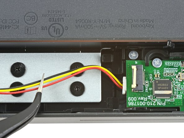

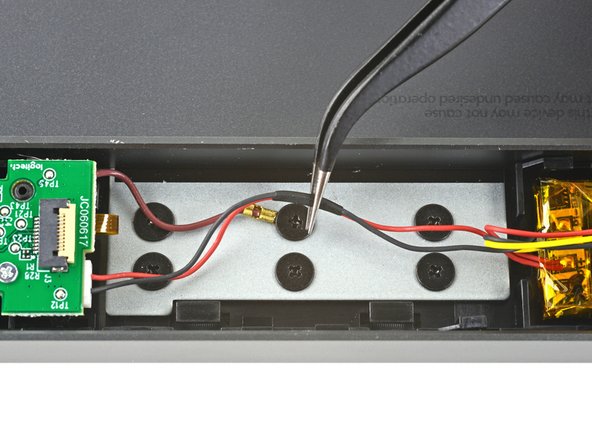

  11. Logitech Craft Battery Replacement, Remove the rest of the foam: crwdns2935265:011crwdnd2935265:01crwdnd2935265:02crwdne2935265:0 Logitech Craft Battery Replacement, Remove the rest of the foam: crwdns2935265:011crwdnd2935265:02crwdnd2935265:02crwdne2935265:0
    • Use a pair of tweezers to remove the two remaining pieces of foam securing the battery wires.
  12. Logitech Craft Battery Replacement, De-route the battery wires: crwdns2935265:012crwdnd2935265:01crwdnd2935265:03crwdne2935265:0 Logitech Craft Battery Replacement, De-route the battery wires: crwdns2935265:012crwdnd2935265:02crwdnd2935265:03crwdne2935265:0 Logitech Craft Battery Replacement, De-route the battery wires: crwdns2935265:012crwdnd2935265:03crwdnd2935265:03crwdne2935265:0
    • Use a pair of tweezers to slide the battery wires out from underneath their plastic routing clips on either side of the battery.

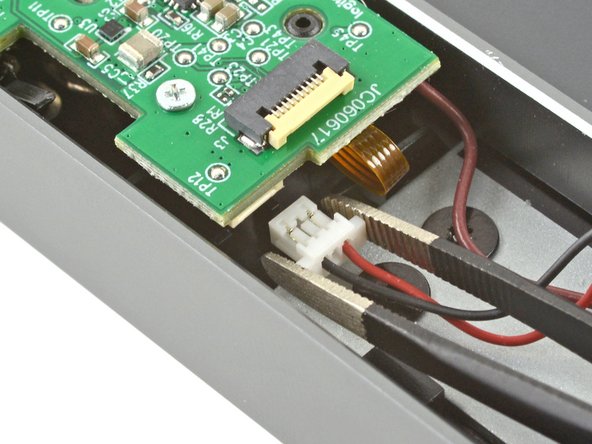

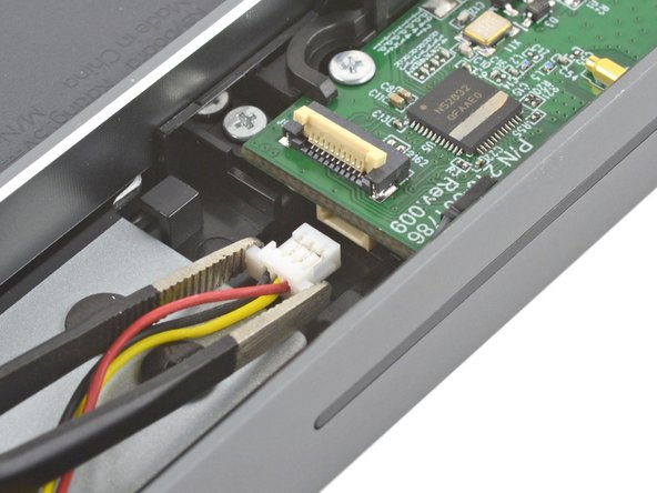

  13. Logitech Craft Battery Replacement, Disconnect both battery connectors: crwdns2935265:013crwdnd2935265:01crwdnd2935265:02crwdne2935265:0 Logitech Craft Battery Replacement, Disconnect both battery connectors: crwdns2935265:013crwdnd2935265:02crwdnd2935265:02crwdne2935265:0
    • Use a pair of tweezers to firmly grip the left battery connector.
    • Hold the tweezers with your fingers as close to the connector as possible to get a firm hold.
    • Gently rock the connector side‑to‑side and slide it straight out of the socket.
    • Always pull cables by their connectors and not the wires themselves.
