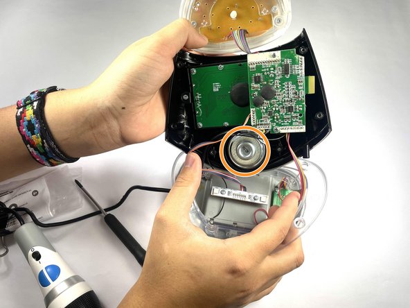

  6. Little Tikes Tobi 2 Interactive Karaoke Machine Speaker Replacement, Speaker: crwdns2935265:06crwdnd2935265:01crwdnd2935265:02crwdne2935265:0 Little Tikes Tobi 2 Interactive Karaoke Machine Speaker Replacement, Speaker: crwdns2935265:06crwdnd2935265:02crwdnd2935265:02crwdne2935265:0
    • Use a Phillips #0 screwdriver to remove the two screws from the diamond-shaped gray plastic cover.
    • Remove the gray cover.
    • Use a hairdryer or heat gun to soften the adhesive securing the speaker.
    • Be careful to not melt the device when using the heat gun. Don't hold it over one area for too long.
    • Use a spudger to remove the speaker.
