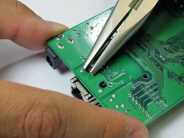

  7. Linksys WAP 11 Network Port Replacement, Network Port: crwdns2935265:07crwdnd2935265:01crwdnd2935265:01crwdne2935265:0
    • Ifixit soldering guide Soldering and desoldering have the potential for harm, always wear proper eye protection and other personal protective equipment while performing either action!
    • Turn the main circuit board around and using a soldering iron and desoldering wick desolder the 12 pins that secure the port to the main board.
  8. Linksys WAP 11 Network Port Replacement: crwdns2935265:08crwdnd2935265:01crwdnd2935265:02crwdne2935265:0 Linksys WAP 11 Network Port Replacement: crwdns2935265:08crwdnd2935265:02crwdnd2935265:02crwdne2935265:0
    • Using a pair of needle-nose pliers, squeeze the two black plastic clips that secure the network port to the board. Squeeze and push down at the same time to push the network board out of place and remove it from the board.
    • To replace the network port, line up the black plastic clips and pop a new network port into the holes. Reassemble in reverse order.
