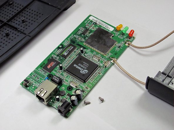

  6. Linksys WAP 11 Motherboard Replacement, Motherboard: crwdns2935265:06crwdnd2935265:01crwdnd2935265:02crwdne2935265:0 Linksys WAP 11 Motherboard Replacement, Motherboard: crwdns2935265:06crwdnd2935265:02crwdnd2935265:02crwdne2935265:0
    • At this point, you may want to remove the antenna leads as well.
    • Once the antennas have been removed, proceed to remove the remaining three phillips screws fastening the motherboard to the case.
    • Once the screws are removed, your motherboard will separate from the housing.
    • Keep these three screws together and separate from the outer case screws.
