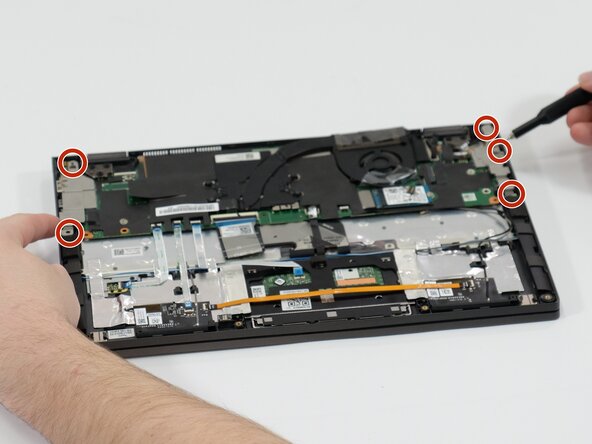

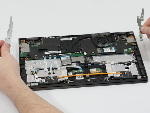

  5. Lenovo Yoga C640-13IML Speakers Replacement, Speakers: crwdns2935265:05crwdnd2935265:01crwdnd2935265:03crwdne2935265:0 Lenovo Yoga C640-13IML Speakers Replacement, Speakers: crwdns2935265:05crwdnd2935265:02crwdnd2935265:03crwdne2935265:0 Lenovo Yoga C640-13IML Speakers Replacement, Speakers: crwdns2935265:05crwdnd2935265:03crwdnd2935265:03crwdne2935265:0
    • Use a Phillips #0 screwdriver to remove the 2.2 mm screws securing the silver shield.
    • Carefully lift the shield off and set it aside.

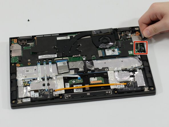

  6. Lenovo Yoga C640-13IML Speakers Replacement: crwdns2935265:06crwdnd2935265:01crwdnd2935265:02crwdne2935265:0 Lenovo Yoga C640-13IML Speakers Replacement: crwdns2935265:06crwdnd2935265:02crwdnd2935265:02crwdne2935265:0
    • Unplug the speaker cable from the port on the motherboard.

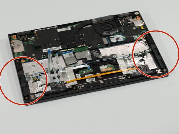

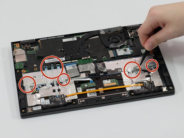

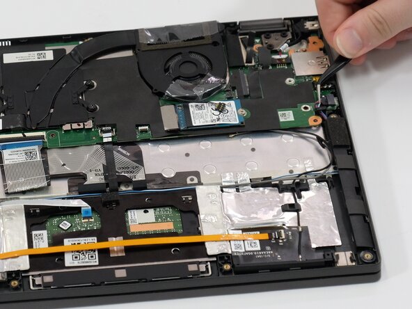

  7. Lenovo Yoga C640-13IML Speakers Replacement: crwdns2935265:07crwdnd2935265:01crwdnd2935265:02crwdne2935265:0 Lenovo Yoga C640-13IML Speakers Replacement: crwdns2935265:07crwdnd2935265:02crwdnd2935265:02crwdne2935265:0
    • Along the wire path, locate all metal tape and cables holding down or going over the speaker cable.
    • Carefully peel off the tape using tweezers or a spudger.
    • For any cable that fully go over the speaker cable carefully unplug and move the off to the side, be sure to remember where they plug back into.
    • Once the tape is removed, gently move the blue and white speaker cables to the side to clear access to the speaker and port areas.

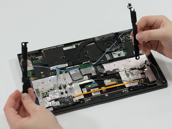

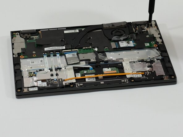

  8. Lenovo Yoga C640-13IML Speakers Replacement: crwdns2935265:08crwdnd2935265:01crwdnd2935265:02crwdne2935265:0 Lenovo Yoga C640-13IML Speakers Replacement: crwdns2935265:08crwdnd2935265:02crwdnd2935265:02crwdne2935265:0
    • To remove the speakers simply lift them up for where they rest and pull them out.
    • If the blue and white cables snag on any of the tape be sure to go back and make sure there is nothing blocking or preventing the removal.
