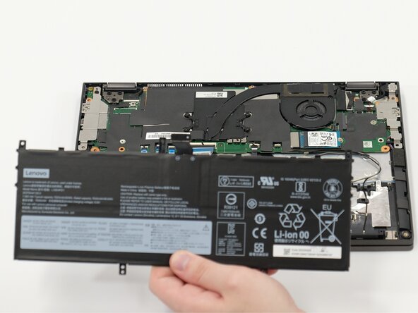

  4. Lenovo Yoga C640-13IML Fan Assembly Replacement: crwdns2935265:04crwdnd2935265:01crwdnd2935265:02crwdne2935265:0 Lenovo Yoga C640-13IML Fan Assembly Replacement: crwdns2935265:04crwdnd2935265:02crwdnd2935265:02crwdne2935265:0
    • Use the flat end of a spudger to lift and unclip the outer edges of the connector. You may need to use your fingers to pull the connector completely out of its socket.
    • Do not pull on the battery wires—only lift from the plastic base of the connector using a spudger.
    • To reconnect the cable, carefully position the connector over its socket and press straight down—the connector should snap into place without much force. If you're having trouble, the connector is most likely misaligned. Reposition it and try again.
    • Lift the battery out of the laptop.

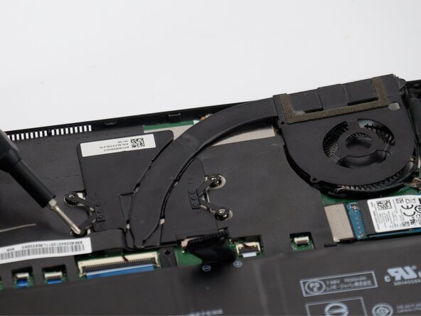

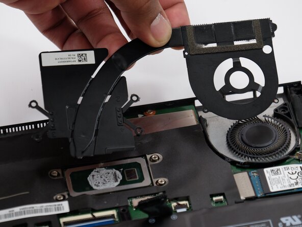

  5. Lenovo Yoga C640-13IML Fan Assembly Replacement, Fan Assembly: crwdns2935265:05crwdnd2935265:01crwdnd2935265:03crwdne2935265:0 Lenovo Yoga C640-13IML Fan Assembly Replacement, Fan Assembly: crwdns2935265:05crwdnd2935265:02crwdnd2935265:03crwdne2935265:0 Lenovo Yoga C640-13IML Fan Assembly Replacement, Fan Assembly: crwdns2935265:05crwdnd2935265:03crwdnd2935265:03crwdne2935265:0
    • Use a Phillips #0 screwdriver to remove the screws securing the fan assembly
    • Lift and remove the housing and heat sink from your device to access the fan underneath.
