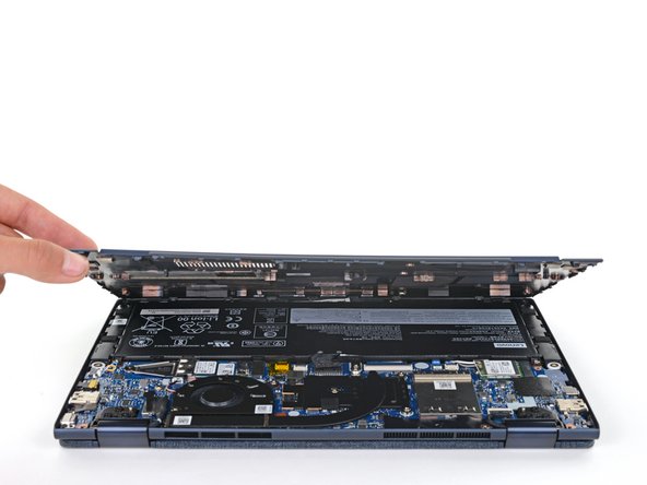

  1. Lenovo Yoga 6 13ALC6 Lower Case Replacement, Unfasten the lower case: crwdns2935265:01crwdnd2935265:01crwdnd2935265:02crwdne2935265:0 Lenovo Yoga 6 13ALC6 Lower Case Replacement, Unfasten the lower case: crwdns2935265:01crwdnd2935265:02crwdnd2935265:02crwdne2935265:0
    • Use a T5 Torx screwdriver to remove the six 7.2 mm screws securing the lower case.
  2. Lenovo Yoga 6 13ALC6 Lower Case Replacement, Insert the opening pick: crwdns2935265:02crwdnd2935265:01crwdnd2935265:02crwdne2935265:0 Lenovo Yoga 6 13ALC6 Lower Case Replacement, Insert the opening pick: crwdns2935265:02crwdnd2935265:02crwdnd2935265:02crwdne2935265:0
    • Insert an opening pick between the lower case and the chassis at a hinge corner.
    • Pry up with the pick to release the clips securing the lower case.
    • Repeat the process on the other hinge corner.
  3. Lenovo Yoga 6 13ALC6 Lower Case Replacement, Release the clips: crwdns2935265:03crwdnd2935265:01crwdnd2935265:03crwdne2935265:0 Lenovo Yoga 6 13ALC6 Lower Case Replacement, Release the clips: crwdns2935265:03crwdnd2935265:02crwdnd2935265:03crwdne2935265:0 Lenovo Yoga 6 13ALC6 Lower Case Replacement, Release the clips: crwdns2935265:03crwdnd2935265:03crwdnd2935265:03crwdne2935265:0
    • Slide the pick along the right edge to release the clips securing the lower case.
  4. Lenovo Yoga 6 13ALC6 Lower Case Replacement, Release the remaining clips: crwdns2935265:04crwdnd2935265:01crwdnd2935265:03crwdne2935265:0 Lenovo Yoga 6 13ALC6 Lower Case Replacement, Release the remaining clips: crwdns2935265:04crwdnd2935265:02crwdnd2935265:03crwdne2935265:0 Lenovo Yoga 6 13ALC6 Lower Case Replacement, Release the remaining clips: crwdns2935265:04crwdnd2935265:03crwdnd2935265:03crwdne2935265:0
    • Continue sliding the opening pick along the front and left edges to release the remaining clips.
  5. Lenovo Yoga 6 13ALC6 Lower Case Replacement: crwdns2935265:05crwdnd2935265:01crwdnd2935265:03crwdne2935265:0 Lenovo Yoga 6 13ALC6 Lower Case Replacement: crwdns2935265:05crwdnd2935265:02crwdnd2935265:03crwdne2935265:0 Lenovo Yoga 6 13ALC6 Lower Case Replacement: crwdns2935265:05crwdnd2935265:03crwdnd2935265:03crwdne2935265:0
    • Insert the pick on the hinge edge and slide along the entire edge to release all of the clips.
  6. Lenovo Yoga 6 13ALC6 Lower Case Replacement: crwdns2935265:06crwdnd2935265:01crwdnd2935265:03crwdne2935265:0 Lenovo Yoga 6 13ALC6 Lower Case Replacement: crwdns2935265:06crwdnd2935265:02crwdnd2935265:03crwdne2935265:0 Lenovo Yoga 6 13ALC6 Lower Case Replacement: crwdns2935265:06crwdnd2935265:03crwdnd2935265:03crwdne2935265:0
    • Lift the lower case from the chassis and remove it.
    • During reassembly, this is a good point to power on your laptop and test all functions before sealing it up. Be sure to power your laptop back down before you continue working.
