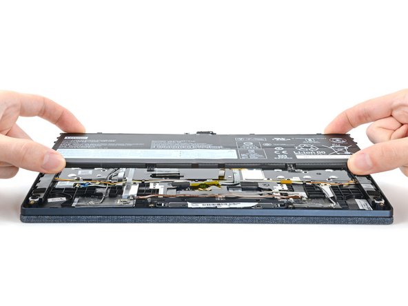

    • Use a Phillips screwdriver to remove the five 4.2 mm-long screws securing the battery.

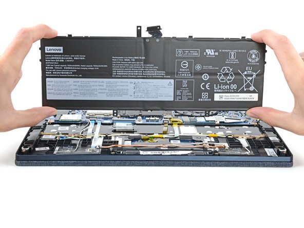

  9. Lenovo Yoga 6 13ALC6 Battery Replacement, Remove the battery: crwdns2935265:09crwdnd2935265:01crwdnd2935265:03crwdne2935265:0 Lenovo Yoga 6 13ALC6 Battery Replacement, Remove the battery: crwdns2935265:09crwdnd2935265:02crwdnd2935265:03crwdne2935265:0 Lenovo Yoga 6 13ALC6 Battery Replacement, Remove the battery: crwdns2935265:09crwdnd2935265:03crwdnd2935265:03crwdne2935265:0
    • Lift the battery straight out of its recess and remove it.
For optimal performance, calibrate your newly installed battery after completing this guide.
