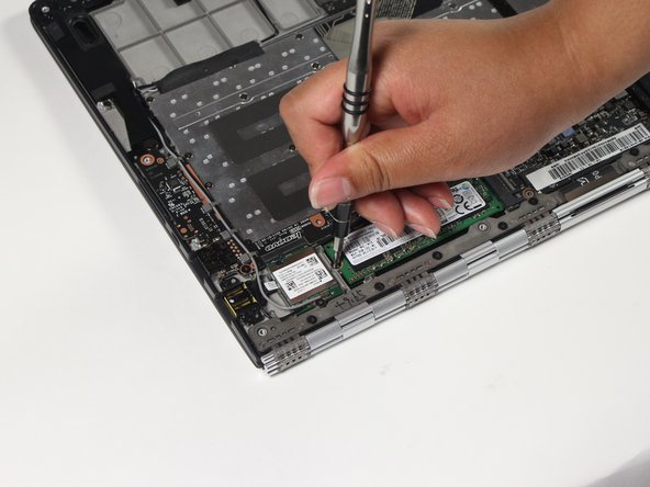

  6. Lenovo Yoga 3 Pro SSD Replacement, SSD: crwdns2935265:06crwdnd2935265:01crwdnd2935265:02crwdne2935265:0 Lenovo Yoga 3 Pro SSD Replacement, SSD: crwdns2935265:06crwdnd2935265:02crwdnd2935265:02crwdne2935265:0
    • Remove the one #0 2.9mm Phillips screw from the SSD.
  7. Lenovo Yoga 3 Pro SSD Replacement: crwdns2935265:07crwdnd2935265:01crwdnd2935265:01crwdne2935265:0
    • Gently lift and wiggle the SSD side to side to remove it from the laptop chassis.

For my Yoga 900 I needed a T5 Torx screw driver. Otherwise spot on.
