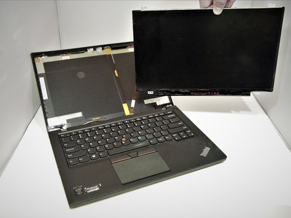

    • Unscrew the screws from each corner of the screen
  4. Lenovo Thinkpad T450s Screen Display Replacement: crwdns2935265:04crwdnd2935265:01crwdnd2935265:01crwdne2935265:0
    • Slowly lean the computer forward so that the screen gently falls into your hand

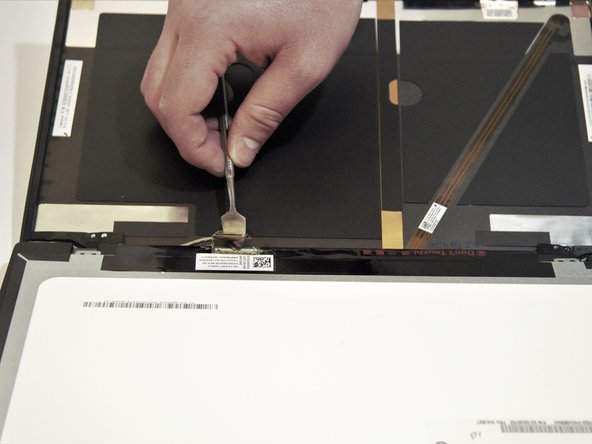

  5. Lenovo Thinkpad T450s Screen Display Replacement: crwdns2935265:05crwdnd2935265:01crwdnd2935265:03crwdne2935265:0 Lenovo Thinkpad T450s Screen Display Replacement: crwdns2935265:05crwdnd2935265:02crwdnd2935265:03crwdne2935265:0 Lenovo Thinkpad T450s Screen Display Replacement: crwdns2935265:05crwdnd2935265:03crwdnd2935265:03crwdne2935265:0
    • Unplug the cord that connects the screen to the rest of the computer
    • Carefully use a metal prying tool to disconnect the two metal prong ends underneath the tape.

there is a step where you remove a simple harness which requires a spudger to de-clip it from the main frame of the laptop, but I gotta say that this walkthrough REALLY was the big difference maker for me in feeling like I could do this job. THANK YOU!!!!!

Correct you are... it important to point that because you can damage it with too much presure trying to get the screen out. Cause I was like, hold up! My screen didnt just flop out like his after removing the four screws that held the screen in place. Luckily, while applying lite pressure trying to get the screen out, the plastic frame popped apart, and I was like okay! Ole boy didnt mention this. So yeah. Please remove that plastic frame before you remove the screen.
Uno!
Alvin Thomas -
Just confirming the missing step: it happens after the unscrewing. Thanks.
