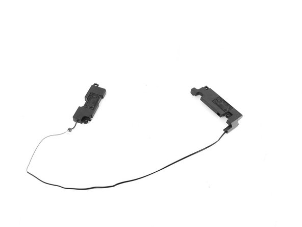

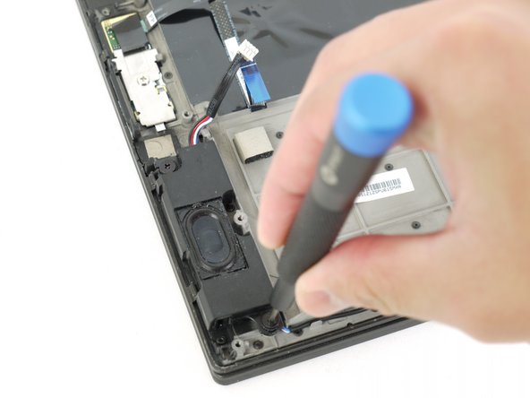

  28. Lenovo Thinkpad T450 Speakers Replacement, Speakers: crwdns2935265:028crwdnd2935265:01crwdnd2935265:02crwdne2935265:0 Lenovo Thinkpad T450 Speakers Replacement, Speakers: crwdns2935265:028crwdnd2935265:02crwdnd2935265:02crwdne2935265:0
    • Using the JIS #00 screwdriver, remove the two 4.2 mm screws securing the left-side speaker to the device.

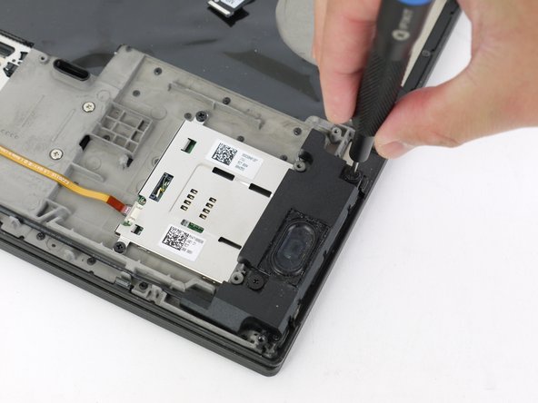

  29. Lenovo Thinkpad T450 Speakers Replacement: crwdns2935265:029crwdnd2935265:01crwdnd2935265:02crwdne2935265:0 Lenovo Thinkpad T450 Speakers Replacement: crwdns2935265:029crwdnd2935265:02crwdnd2935265:02crwdne2935265:0
    • Use the same JIS #00 screwdriver to remove two 4.2 mm screws from the right-side speaker.

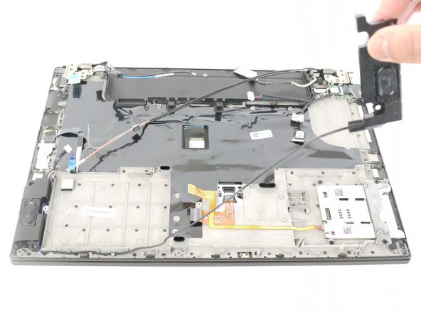

  30. Lenovo Thinkpad T450 Speakers Replacement: crwdns2935265:030crwdnd2935265:01crwdnd2935265:03crwdne2935265:0 Lenovo Thinkpad T450 Speakers Replacement: crwdns2935265:030crwdnd2935265:02crwdnd2935265:03crwdne2935265:0 Lenovo Thinkpad T450 Speakers Replacement: crwdns2935265:030crwdnd2935265:03crwdnd2935265:03crwdne2935265:0
    • Grab the speakers and unravel the cables to remove it from the device.
