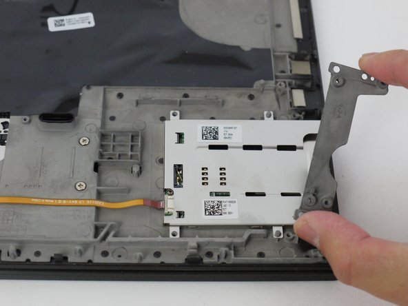

  28. Lenovo Thinkpad T450 Smartcard Reader Replacement, Smartcard Reader: crwdns2935265:028crwdnd2935265:01crwdnd2935265:02crwdne2935265:0 Lenovo Thinkpad T450 Smartcard Reader Replacement, Smartcard Reader: crwdns2935265:028crwdnd2935265:02crwdnd2935265:02crwdne2935265:0
    • Using the JIS #00 screwdriver, remove the four 2.8 mm screws securing the smartcard reader and bracket to the device.
  29. Lenovo Thinkpad T450 Smartcard Reader Replacement: crwdns2935265:029crwdnd2935265:01crwdnd2935265:03crwdne2935265:0 Lenovo Thinkpad T450 Smartcard Reader Replacement: crwdns2935265:029crwdnd2935265:02crwdnd2935265:03crwdne2935265:0 Lenovo Thinkpad T450 Smartcard Reader Replacement: crwdns2935265:029crwdnd2935265:03crwdnd2935265:03crwdne2935265:0
    • Remove the smartcard reader bracket from the device.

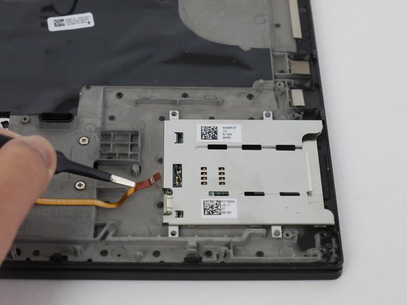

  30. Lenovo Thinkpad T450 Smartcard Reader Replacement: crwdns2935265:030crwdnd2935265:01crwdnd2935265:02crwdne2935265:0 Lenovo Thinkpad T450 Smartcard Reader Replacement: crwdns2935265:030crwdnd2935265:02crwdnd2935265:02crwdne2935265:0
    • Disconnect the smartcard reader cable from the smartcard reader.
  31. Lenovo Thinkpad T450 Smartcard Reader Replacement: crwdns2935265:031crwdnd2935265:01crwdnd2935265:02crwdne2935265:0 Lenovo Thinkpad T450 Smartcard Reader Replacement: crwdns2935265:031crwdnd2935265:02crwdnd2935265:02crwdne2935265:0
    • Lift up the smartcard reader and remove it from the device.
