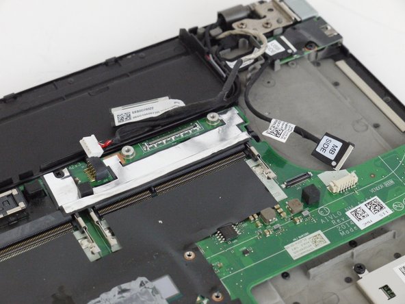

  4. Lenovo Thinkpad T450 Daughterboard Replacement, RAM: crwdns2935265:04crwdnd2935265:01crwdnd2935265:02crwdne2935265:0 Lenovo Thinkpad T450 Daughterboard Replacement, RAM: crwdns2935265:04crwdnd2935265:02crwdnd2935265:02crwdne2935265:0
    • Lift up the black piece of tape and remove it to uncover the RAM sticks underneath.
  5. Lenovo Thinkpad T450 Daughterboard Replacement: crwdns2935265:05crwdnd2935265:01crwdnd2935265:02crwdne2935265:0 Lenovo Thinkpad T450 Daughterboard Replacement: crwdns2935265:05crwdnd2935265:02crwdnd2935265:02crwdne2935265:0
    • Using your fingers, push the two clips securing the RAM away from each other to release the RAM.
    • The RAM stick should pop up at a 30 degree angle.
    • Remove the RAM stick from the device.
    • Repeat this step for any additional RAM sticks.

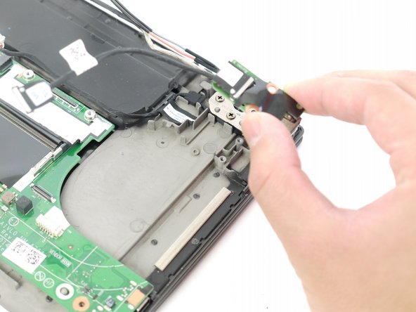

  9. Lenovo Thinkpad T450 Daughterboard Replacement, Daughterboard: crwdns2935265:09crwdnd2935265:01crwdnd2935265:02crwdne2935265:0 Lenovo Thinkpad T450 Daughterboard Replacement, Daughterboard: crwdns2935265:09crwdnd2935265:02crwdnd2935265:02crwdne2935265:0
    • Use the plastic opening tool to disconnect the daughterboard cable from the motherboard.
  10. Lenovo Thinkpad T450 Daughterboard Replacement: crwdns2935265:010crwdnd2935265:01crwdnd2935265:02crwdne2935265:0 Lenovo Thinkpad T450 Daughterboard Replacement: crwdns2935265:010crwdnd2935265:02crwdnd2935265:02crwdne2935265:0
    • Using the JIS #00 screwdriver, remove the two 2.8 mm screws securing the daughterboard to the device.
  11. Lenovo Thinkpad T450 Daughterboard Replacement: crwdns2935265:011crwdnd2935265:01crwdnd2935265:02crwdne2935265:0 Lenovo Thinkpad T450 Daughterboard Replacement: crwdns2935265:011crwdnd2935265:02crwdnd2935265:02crwdne2935265:0
    • Lift up and remove the daughterboard from the device.
