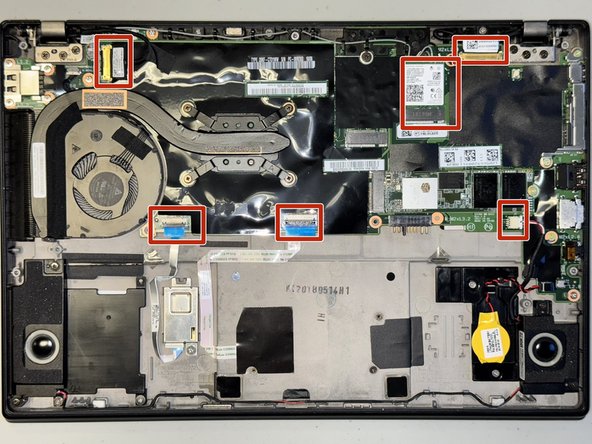

  5. Lenovo ThinkPad X280 Power Jack Replacement, Power Jack: crwdns2935265:05crwdnd2935265:01crwdnd2935265:02crwdne2935265:0 Lenovo ThinkPad X280 Power Jack Replacement, Power Jack: crwdns2935265:05crwdnd2935265:02crwdnd2935265:02crwdne2935265:0
    • Disconnect all six ribbon cables connected to the motherboard by gently with a screwdriver or your fingers.
    • Flip up the locking flaps before disconnecting the cables where pertinent.

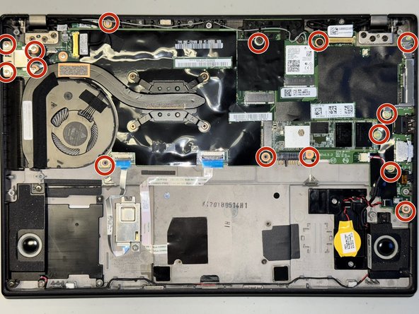

  8. Lenovo ThinkPad X280 Power Jack Replacement: crwdns2935265:08crwdnd2935265:01crwdnd2935265:02crwdne2935265:0 Lenovo ThinkPad X280 Power Jack Replacement: crwdns2935265:08crwdnd2935265:02crwdnd2935265:02crwdne2935265:0
    • Remove all fifteen 3.4 mm screws securing the motherboard with a Phillips #1 screwdriver.
  9. Lenovo ThinkPad X280 Power Jack Replacement: crwdns2935265:09crwdnd2935265:01crwdnd2935265:03crwdne2935265:0 Lenovo ThinkPad X280 Power Jack Replacement: crwdns2935265:09crwdnd2935265:02crwdnd2935265:03crwdne2935265:0 Lenovo ThinkPad X280 Power Jack Replacement: crwdns2935265:09crwdnd2935265:03crwdnd2935265:03crwdne2935265:0
    • Lift out the mother board to access the power jack to replace it with a new one.
    • The power jack will have to be desoldered and then the replacement resoldered. Check out this handy guide to help guide you.
