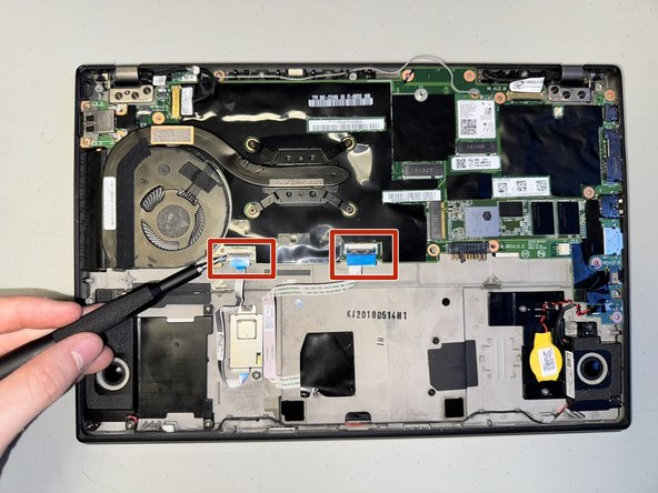

    • use a screwdriver or a spudger to flip up the two black ZIF locking flaps that secure the ribbon cables.
    • Disconnect the two ribbon cables.
  14. Lenovo ThinkPad X280 Motherboard Replacement: crwdns2935265:014crwdnd2935265:01crwdnd2935265:02crwdne2935265:0 Lenovo ThinkPad X280 Motherboard Replacement: crwdns2935265:014crwdnd2935265:02crwdnd2935265:02crwdne2935265:0
    • Carefully use a spudger or a screwdriver to flip up the two locking flaps the metal retaining clips and disconnect the two ribbon cables from their sockets.

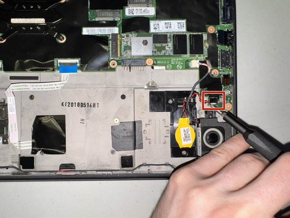

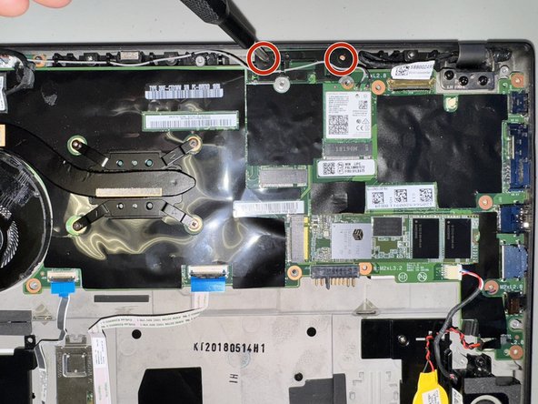

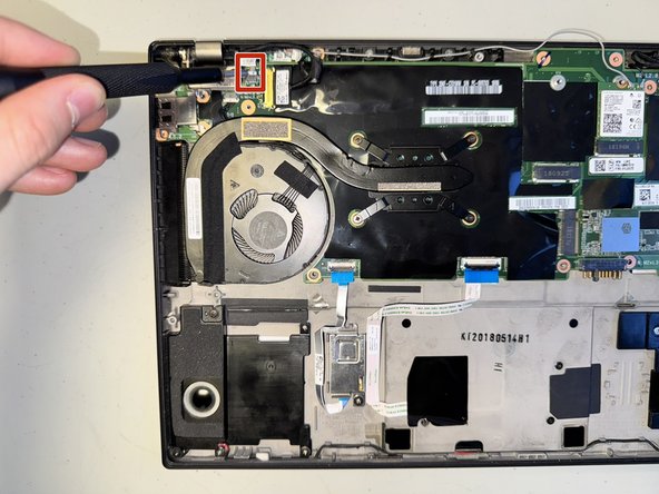

    • Use nails or a spudger to gently disconnect the first two plastic connectors from the motherboard by carefully pulling each one straight out of its socket.
    • Disconnect the power button (third picture) with a spudger by nudging it, alternating on right and left sides, until it can be pulled out.
    • This is the most difficult part of this guide, it is finicky.
    • Avoid applying excessive force to prevent damage. Do not pull on the cables themselves!

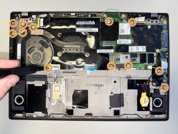

  17. Lenovo ThinkPad X280 Motherboard Replacement: crwdns2935265:017crwdnd2935265:01crwdnd2935265:03crwdne2935265:0 Lenovo ThinkPad X280 Motherboard Replacement: crwdns2935265:017crwdnd2935265:02crwdnd2935265:03crwdne2935265:0 Lenovo ThinkPad X280 Motherboard Replacement: crwdns2935265:017crwdnd2935265:03crwdnd2935265:03crwdne2935265:0
    • Remove the four 5.4 mm screws securing both the metal and plastic covers using a Phillips #1 screwdriver.
    • Gently lift and remove the covers to expose the internal components.
    • Unscrew the remaining fourteen 3.4 mm screws using a Phillips #1 screwdriver.

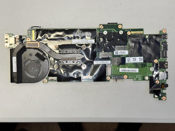

    • Carefully lift the motherboard by gently bending it to release it from its secured position.
    • Once it is loose, pull it out and away from the case, ensuring all connectors and screws are detached to avoid damage.
