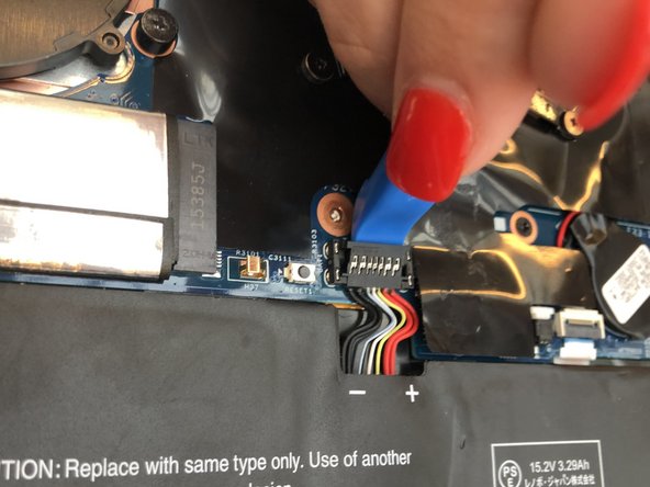

    • Lift the plastic black strip cover that's laying over the battery connector.
    • Use the iFixit opening tool to flip up and disconnect the black battery connector from its motherboard socket.
    • Gently pull the connector away from the battery to pull it out of the slot.

Hello, I was able to install the battery on my X1 carbon, but the laptop is not detecting my battery. How to remove whitelisting on X1 carbon yoga 1st gen?
Delta Force - crwdns2934203:0crwdne2934203:0
Did you find a solution for your problem? Because i have the same problem since i changed my battery :/
