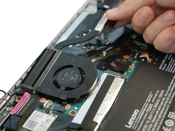

  4. Lenovo ThinkPad X1 Yoga 2nd Generation Fan Replacement, Fan: crwdns2935265:04crwdnd2935265:01crwdnd2935265:02crwdne2935265:0 Lenovo ThinkPad X1 Yoga 2nd Generation Fan Replacement, Fan: crwdns2935265:04crwdnd2935265:02crwdnd2935265:02crwdne2935265:0
    • Lift up the small, metal tab using a spudger.
    • Do not use the metal spudger unless if it's being used for serious prying power. The metal spudger may damage or puncture internal components in the device if too much pressure is applied.
    • Gently lift the ribbon cable from its socket using nylon-tipped reverse tweezers.
  5. Lenovo ThinkPad X1 Yoga 2nd Generation Fan Replacement: crwdns2935265:05crwdnd2935265:01crwdnd2935265:01crwdne2935265:0
    • Using the Phillips #0 screwdriver, unscrew the four 4 mm screws directly next to the fan.
  6. Lenovo ThinkPad X1 Yoga 2nd Generation Fan Replacement: crwdns2935265:06crwdnd2935265:01crwdnd2935265:02crwdne2935265:0 Lenovo ThinkPad X1 Yoga 2nd Generation Fan Replacement: crwdns2935265:06crwdnd2935265:02crwdnd2935265:02crwdne2935265:0
    • Loosen the four 5 mm screws in the metal extension attached to the fan.
    • The screws do not need to be completely removed from the fan.
    • Remove the fan using your fingers.
