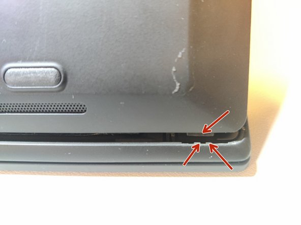

  2. Lenovo ThinkPad X1 Carbon 6th Gen CMOS Battery Replacement, Remove The Back Cover: crwdns2935265:02crwdnd2935265:01crwdnd2935265:03crwdne2935265:0 Lenovo ThinkPad X1 Carbon 6th Gen CMOS Battery Replacement, Remove The Back Cover: crwdns2935265:02crwdnd2935265:02crwdnd2935265:03crwdne2935265:0 Lenovo ThinkPad X1 Carbon 6th Gen CMOS Battery Replacement, Remove The Back Cover: crwdns2935265:02crwdnd2935265:03crwdnd2935265:03crwdne2935265:0
    • Unscrew the 5 screws holding the back cover on.
    • Use a spudger or pry tool to release the retention clips on the cover at the indicated points
    • Tilt the top of the cover up and away from the body, then remove the cover.

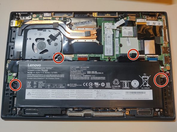

  3. Lenovo ThinkPad X1 Carbon 6th Gen CMOS Battery Replacement, Remove The Battery: crwdns2935265:03crwdnd2935265:01crwdnd2935265:03crwdne2935265:0 Lenovo ThinkPad X1 Carbon 6th Gen CMOS Battery Replacement, Remove The Battery: crwdns2935265:03crwdnd2935265:02crwdnd2935265:03crwdne2935265:0 Lenovo ThinkPad X1 Carbon 6th Gen CMOS Battery Replacement, Remove The Battery: crwdns2935265:03crwdnd2935265:03crwdnd2935265:03crwdne2935265:0
    • Unscrew the 4 screws holding the battery in place.
    • Disconnect the battery by prying it away from the chassis at the indicated point.
    • Remove the battery.

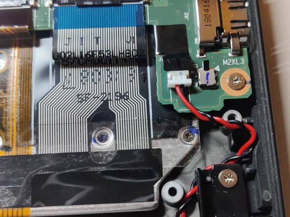

  4. Lenovo ThinkPad X1 Carbon 6th Gen CMOS Battery Replacement, Remove the original CMOS battery: crwdns2935265:04crwdnd2935265:01crwdnd2935265:03crwdne2935265:0 Lenovo ThinkPad X1 Carbon 6th Gen CMOS Battery Replacement, Remove the original CMOS battery: crwdns2935265:04crwdnd2935265:02crwdnd2935265:03crwdne2935265:0 Lenovo ThinkPad X1 Carbon 6th Gen CMOS Battery Replacement, Remove the original CMOS battery: crwdns2935265:04crwdnd2935265:03crwdnd2935265:03crwdne2935265:0
    • Disconnect the CMOS battery connector. A spudger may be helpful here.
    • Pry up the original CMOS battery. A spudger or pry tool may be helpful here.

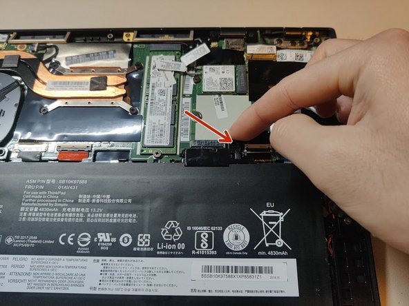

  6. Lenovo ThinkPad X1 Carbon 6th Gen CMOS Battery Replacement, Perform a test fit with the new CMOs battery: crwdns2935265:06crwdnd2935265:01crwdnd2935265:03crwdne2935265:0 Lenovo ThinkPad X1 Carbon 6th Gen CMOS Battery Replacement, Perform a test fit with the new CMOs battery: crwdns2935265:06crwdnd2935265:02crwdnd2935265:03crwdne2935265:0 Lenovo ThinkPad X1 Carbon 6th Gen CMOS Battery Replacement, Perform a test fit with the new CMOs battery: crwdns2935265:06crwdnd2935265:03crwdnd2935265:03crwdne2935265:0
    • Place the new CMOS battery in the same spot as the original.
    • If the new CMOS battery comes with pre-applied adhesive, do NOT remove the adhesive backing paper yet.
    • Align the tabs on the bottom of the main battery with the retention clips on the chassis and slide the tabs into place.
    • Press down on the battery connector to fully seat it.

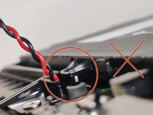

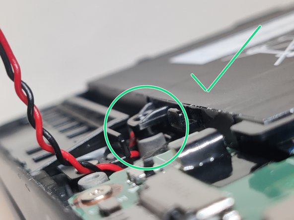

  7. Lenovo ThinkPad X1 Carbon 6th Gen CMOS Battery Replacement, Check the fit of the new CMOS battery: crwdns2935265:07crwdnd2935265:01crwdnd2935265:03crwdne2935265:0 Lenovo ThinkPad X1 Carbon 6th Gen CMOS Battery Replacement, Check the fit of the new CMOS battery: crwdns2935265:07crwdnd2935265:02crwdnd2935265:03crwdne2935265:0 Lenovo ThinkPad X1 Carbon 6th Gen CMOS Battery Replacement, Check the fit of the new CMOS battery: crwdns2935265:07crwdnd2935265:03crwdnd2935265:03crwdne2935265:0
    • Check the fit between the tab on the battery and the screw standoff on the chassis closest to the CMOS battery.
    • There should be almost no gap between the battery tab and the standoff. The clearance circled in green is acceptable. The clearance circled in red is not acceptable.
    • If there is too large of a gap, screwing in the main battery will bend it and put stress on it, which could cause damage.
  8. Lenovo ThinkPad X1 Carbon 6th Gen CMOS Battery Replacement, Adjust CMOS battery thickness: crwdns2935265:08crwdnd2935265:01crwdnd2935265:01crwdne2935265:0
    • If there was too large of a gap during the fit check, remove any pre-applied padding/adhesive from the new battery to decrease the thickness.
    • Repeat the fit check.

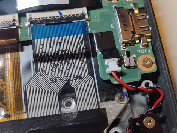

  9. Lenovo ThinkPad X1 Carbon 6th Gen CMOS Battery Replacement, Connect the new CMOS battery: crwdns2935265:09crwdnd2935265:01crwdnd2935265:03crwdne2935265:0 Lenovo ThinkPad X1 Carbon 6th Gen CMOS Battery Replacement, Connect the new CMOS battery: crwdns2935265:09crwdnd2935265:02crwdnd2935265:03crwdne2935265:0 Lenovo ThinkPad X1 Carbon 6th Gen CMOS Battery Replacement, Connect the new CMOS battery: crwdns2935265:09crwdnd2935265:03crwdnd2935265:03crwdne2935265:0
    • Align the connector of the new battery with it's receptacle on the circuit board. The openings on the connector should be a the top.
    • The connector should only fit in one orientation. If it does not easily connect, try a different orientation.
    • Push the connector directly into its receptacle until it clicks into place.
