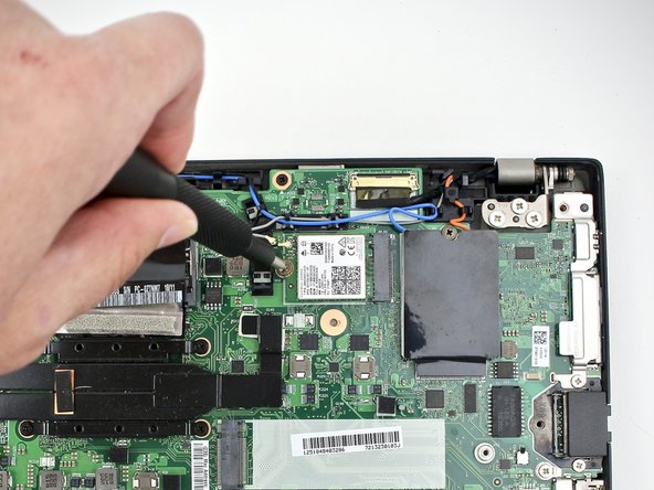

  4. Lenovo ThinkPad T480s Wi-Fi Card Replacement, Wi-Fi Card: crwdns2935265:04crwdnd2935265:01crwdnd2935265:03crwdne2935265:0 Lenovo ThinkPad T480s Wi-Fi Card Replacement, Wi-Fi Card: crwdns2935265:04crwdnd2935265:02crwdnd2935265:03crwdne2935265:0 Lenovo ThinkPad T480s Wi-Fi Card Replacement, Wi-Fi Card: crwdns2935265:04crwdnd2935265:03crwdnd2935265:03crwdne2935265:0
    • Using the nylon spudger, pop the coaxial antenna wires off the Wi-Fi card.
    • When reassembling, reattach the gray wire closest to the screw and the black wire on the other side of the gray wire.

Hi, thanks a lot the helpful guide. I have just replaced the WiFi card in my Lenovo T480s with a Intel AX210NGW. My laptop won't boot up. Even when I plug the power adapter into the laptop, the status indicator does not light up. I have removed the WiFi card and tried to power it on without it but no luck. I put back the one that was in before still no luck. I'm stuck, what can I do? Did some power component get disturbed or something? I'd appreciate any help. Thank you.
