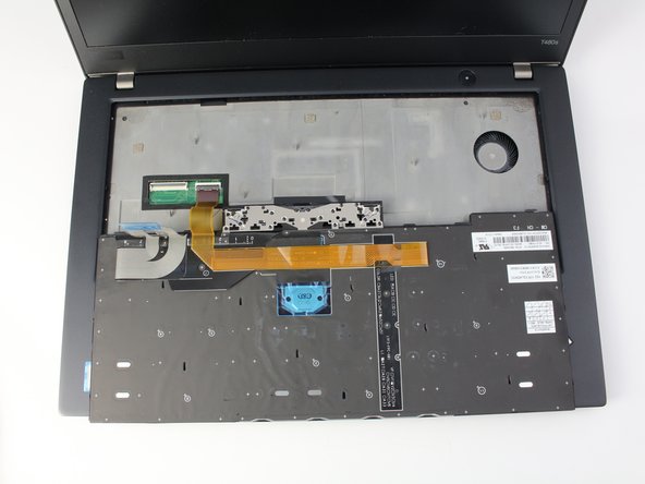

    • Gently, pull the keyboard out from the bezel and flip it over.
    • It is connected to the keyboard and trackpad cables so be sure not to yank it over to avoid tearing them.
  5. Lenovo ThinkPad T480s Keyboard Replacement: crwdns2935265:05crwdnd2935265:01crwdnd2935265:03crwdne2935265:0 Lenovo ThinkPad T480s Keyboard Replacement: crwdns2935265:05crwdnd2935265:02crwdnd2935265:03crwdne2935265:0 Lenovo ThinkPad T480s Keyboard Replacement: crwdns2935265:05crwdnd2935265:03crwdnd2935265:03crwdne2935265:0

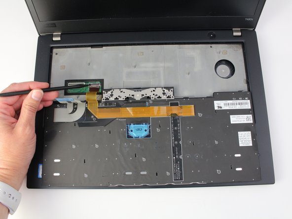

    • Use the spudger to disconnect the trackpad cable from the system.
    • For more information on types of connectors, check out this guide.
  6. Lenovo ThinkPad T480s Keyboard Replacement: crwdns2935265:06crwdnd2935265:01crwdnd2935265:03crwdne2935265:0 Lenovo ThinkPad T480s Keyboard Replacement: crwdns2935265:06crwdnd2935265:02crwdnd2935265:03crwdne2935265:0 Lenovo ThinkPad T480s Keyboard Replacement: crwdns2935265:06crwdnd2935265:03crwdnd2935265:03crwdne2935265:0
    • Use the spudger to disconnect the keyboard cable from the system.
