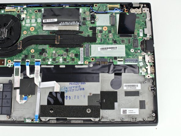

  11. Lenovo ThinkPad T480s Coin Cell Battery Replacement, SD Card Reader/Audio Card: crwdns2935265:011crwdnd2935265:01crwdnd2935265:03crwdne2935265:0 Lenovo ThinkPad T480s Coin Cell Battery Replacement, SD Card Reader/Audio Card: crwdns2935265:011crwdnd2935265:02crwdnd2935265:03crwdne2935265:0 Lenovo ThinkPad T480s Coin Cell Battery Replacement, SD Card Reader/Audio Card: crwdns2935265:011crwdnd2935265:03crwdnd2935265:03crwdne2935265:0
    • Use a spudger to lift up the retaining flap on the SD card reader/audio card connector.
  12. Lenovo ThinkPad T480s Coin Cell Battery Replacement: crwdns2935265:012crwdnd2935265:01crwdnd2935265:02crwdne2935265:0 Lenovo ThinkPad T480s Coin Cell Battery Replacement: crwdns2935265:012crwdnd2935265:02crwdnd2935265:02crwdne2935265:0
    • Use the spudger to remove the cable from the connector.

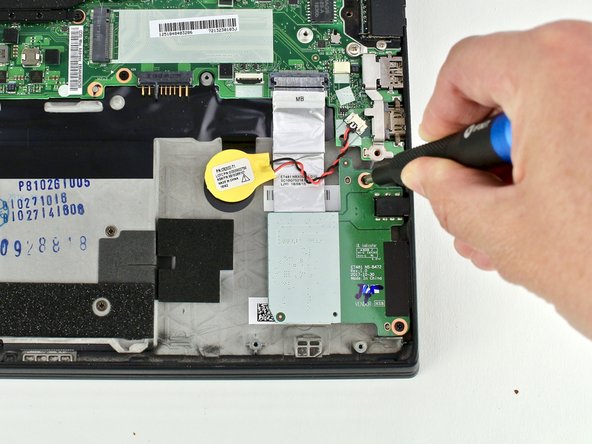

    • The cable is attached to the board with adhesive so you will need to peel the cable up.
  13. Lenovo ThinkPad T480s Coin Cell Battery Replacement: crwdns2935265:013crwdnd2935265:01crwdnd2935265:02crwdne2935265:0 Lenovo ThinkPad T480s Coin Cell Battery Replacement: crwdns2935265:013crwdnd2935265:02crwdnd2935265:02crwdne2935265:0
    • Use the Phillips #1 screwdriver to remove two 3.1 mm screws from the card.

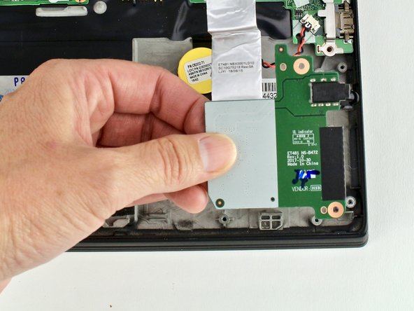

  14. Lenovo ThinkPad T480s Coin Cell Battery Replacement: crwdns2935265:014crwdnd2935265:01crwdnd2935265:03crwdne2935265:0 Lenovo ThinkPad T480s Coin Cell Battery Replacement: crwdns2935265:014crwdnd2935265:02crwdnd2935265:03crwdne2935265:0 Lenovo ThinkPad T480s Coin Cell Battery Replacement: crwdns2935265:014crwdnd2935265:03crwdnd2935265:03crwdne2935265:0
    • Lift the SD card reader/audio card from the system by sliding it out from the socket.
    • You will need to slide the audio card ribbon cable under the coin cell battery cable to remove the SD card reader from the system.

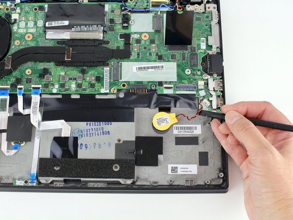

  15. Lenovo ThinkPad T480s Coin Cell Battery Replacement, Coin Cell Battery: crwdns2935265:015crwdnd2935265:01crwdnd2935265:03crwdne2935265:0 Lenovo ThinkPad T480s Coin Cell Battery Replacement, Coin Cell Battery: crwdns2935265:015crwdnd2935265:02crwdnd2935265:03crwdne2935265:0 Lenovo ThinkPad T480s Coin Cell Battery Replacement, Coin Cell Battery: crwdns2935265:015crwdnd2935265:03crwdnd2935265:03crwdne2935265:0
    • Use a connector puller or spudger to disconnect the coin cell cable from the system board.

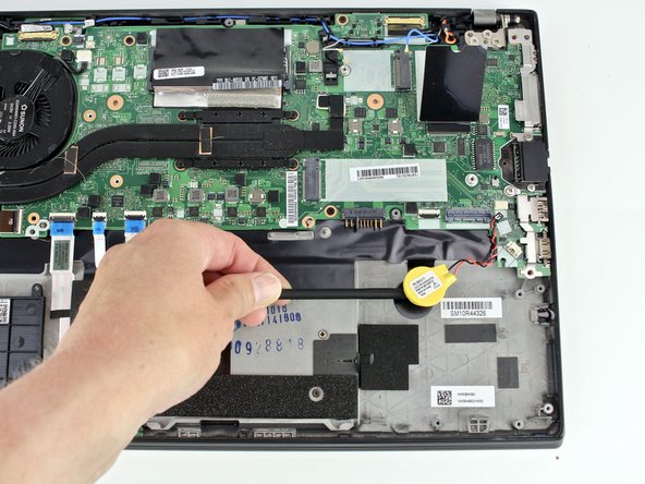

  16. Lenovo ThinkPad T480s Coin Cell Battery Replacement: crwdns2935265:016crwdnd2935265:01crwdnd2935265:03crwdne2935265:0 Lenovo ThinkPad T480s Coin Cell Battery Replacement: crwdns2935265:016crwdnd2935265:02crwdnd2935265:03crwdne2935265:0 Lenovo ThinkPad T480s Coin Cell Battery Replacement: crwdns2935265:016crwdnd2935265:03crwdnd2935265:03crwdne2935265:0

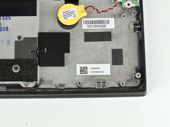

    • Use the spudger to pry the coin cell battery up from the frame.
    • When reassembling, you may need to apply adhesive to the battery so it sticks to the motherboard.
