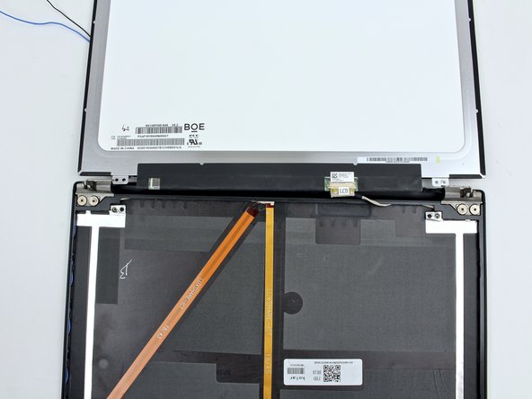

  12. Lenovo ThinkPad T480s Camera/LED Cable Replacement, LCD Panel: crwdns2935265:012crwdnd2935265:01crwdnd2935265:02crwdne2935265:0 Lenovo ThinkPad T480s Camera/LED Cable Replacement, LCD Panel: crwdns2935265:012crwdnd2935265:02crwdnd2935265:02crwdne2935265:0
    • Remove four 2.9 mm screws from the LCD panel using the Phillips #1 screwdriver.
  13. Lenovo ThinkPad T480s Camera/LED Cable Replacement: crwdns2935265:013crwdnd2935265:01crwdnd2935265:03crwdne2935265:0 Lenovo ThinkPad T480s Camera/LED Cable Replacement: crwdns2935265:013crwdnd2935265:02crwdnd2935265:03crwdne2935265:0 Lenovo ThinkPad T480s Camera/LED Cable Replacement: crwdns2935265:013crwdnd2935265:03crwdnd2935265:03crwdne2935265:0
    • Gently lift the panel and flip it over.
    • The panel is still connected to the unit by the LCD cable, so be careful not to rip the connector when flipping it over.
  14. Lenovo ThinkPad T480s Camera/LED Cable Replacement: crwdns2935265:014crwdnd2935265:01crwdnd2935265:02crwdne2935265:0 Lenovo ThinkPad T480s Camera/LED Cable Replacement: crwdns2935265:014crwdnd2935265:02crwdnd2935265:02crwdne2935265:0
    • Peel back the tape covering the LCD cable connector.
    • Use the spudger to unlock the LCD cable.
  15. Lenovo ThinkPad T480s Camera/LED Cable Replacement: crwdns2935265:015crwdnd2935265:01crwdnd2935265:02crwdne2935265:0 Lenovo ThinkPad T480s Camera/LED Cable Replacement: crwdns2935265:015crwdnd2935265:02crwdnd2935265:02crwdne2935265:0
    • Remove the LCD cable from the socket.
  16. Lenovo ThinkPad T480s Camera/LED Cable Replacement: crwdns2935265:016crwdnd2935265:01crwdnd2935265:02crwdne2935265:0 Lenovo ThinkPad T480s Camera/LED Cable Replacement: crwdns2935265:016crwdnd2935265:02crwdnd2935265:02crwdne2935265:0
    • Remove the LCD panel from the system.
  17. Lenovo ThinkPad T480s Camera/LED Cable Replacement, Hinges: crwdns2935265:017crwdnd2935265:01crwdnd2935265:02crwdne2935265:0 Lenovo ThinkPad T480s Camera/LED Cable Replacement, Hinges: crwdns2935265:017crwdnd2935265:02crwdnd2935265:02crwdne2935265:0
    • Use the Phillips #1 screwdriver to remove two 2.8 mm screws from the hinge in the upper right corner.
  18. Lenovo ThinkPad T480s Camera/LED Cable Replacement: crwdns2935265:018crwdnd2935265:01crwdnd2935265:02crwdne2935265:0 Lenovo ThinkPad T480s Camera/LED Cable Replacement: crwdns2935265:018crwdnd2935265:02crwdnd2935265:02crwdne2935265:0
    • Remove the hinge in the upper right corner.
  19. Lenovo ThinkPad T480s Camera/LED Cable Replacement: crwdns2935265:019crwdnd2935265:01crwdnd2935265:02crwdne2935265:0 Lenovo ThinkPad T480s Camera/LED Cable Replacement: crwdns2935265:019crwdnd2935265:02crwdnd2935265:02crwdne2935265:0
    • Use a Phillips #1 screwdriver to remove two 2.8 mm screws from the hinge in the upper left corner.
  20. Lenovo ThinkPad T480s Camera/LED Cable Replacement: crwdns2935265:020crwdnd2935265:01crwdnd2935265:02crwdne2935265:0 Lenovo ThinkPad T480s Camera/LED Cable Replacement: crwdns2935265:020crwdnd2935265:02crwdnd2935265:02crwdne2935265:0
    • Remove the hinge in the upper left corner.
  21. Lenovo ThinkPad T480s Camera/LED Cable Replacement, Camera/LED Cable: crwdns2935265:021crwdnd2935265:01crwdnd2935265:03crwdne2935265:0 Lenovo ThinkPad T480s Camera/LED Cable Replacement, Camera/LED Cable: crwdns2935265:021crwdnd2935265:02crwdnd2935265:03crwdne2935265:0 Lenovo ThinkPad T480s Camera/LED Cable Replacement, Camera/LED Cable: crwdns2935265:021crwdnd2935265:03crwdnd2935265:03crwdne2935265:0
    • Use the spudger to disconnect the cable from the camera card, then peel the cable up from the LCD unit.
  22. Lenovo ThinkPad T480s Camera/LED Cable Replacement: crwdns2935265:022crwdnd2935265:01crwdnd2935265:02crwdne2935265:0 Lenovo ThinkPad T480s Camera/LED Cable Replacement: crwdns2935265:022crwdnd2935265:02crwdnd2935265:02crwdne2935265:0
    • Peel the ThinkPad logo LED cable from the LCD unit and remove the cables from the system.
