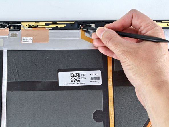

  17. Lenovo ThinkPad T480s Camera Replacement, Camera: crwdns2935265:017crwdnd2935265:01crwdnd2935265:03crwdne2935265:0 Lenovo ThinkPad T480s Camera Replacement, Camera: crwdns2935265:017crwdnd2935265:02crwdnd2935265:03crwdne2935265:0 Lenovo ThinkPad T480s Camera Replacement, Camera: crwdns2935265:017crwdnd2935265:03crwdnd2935265:03crwdne2935265:0
    • Using a spudger, disconnect the cable from the camera.

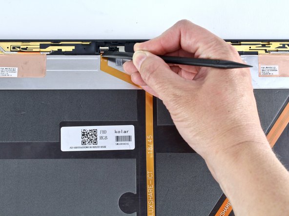

  18. Lenovo ThinkPad T480s Camera Replacement: crwdns2935265:018crwdnd2935265:01crwdnd2935265:03crwdne2935265:0 Lenovo ThinkPad T480s Camera Replacement: crwdns2935265:018crwdnd2935265:02crwdnd2935265:03crwdne2935265:0 Lenovo ThinkPad T480s Camera Replacement: crwdns2935265:018crwdnd2935265:03crwdnd2935265:03crwdne2935265:0
    • Use a spudger to pry the camera up from the LCD Unit.
