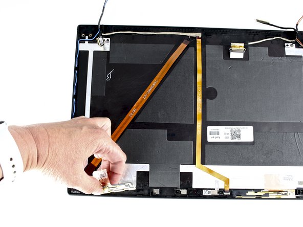

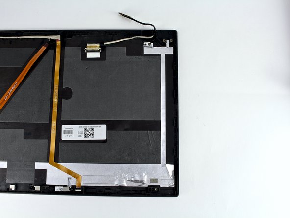

  21. Lenovo ThinkPad T480s Antenna Kit Replacement, Antenna Kit: crwdns2935265:021crwdnd2935265:01crwdnd2935265:03crwdne2935265:0 Lenovo ThinkPad T480s Antenna Kit Replacement, Antenna Kit: crwdns2935265:021crwdnd2935265:02crwdnd2935265:03crwdne2935265:0 Lenovo ThinkPad T480s Antenna Kit Replacement, Antenna Kit: crwdns2935265:021crwdnd2935265:03crwdnd2935265:03crwdne2935265:0
    • Pry the metallic tape and the black and blue antenna from the LCD Unit.
  22. Lenovo ThinkPad T480s Antenna Kit Replacement: crwdns2935265:022crwdnd2935265:01crwdnd2935265:02crwdne2935265:0 Lenovo ThinkPad T480s Antenna Kit Replacement: crwdns2935265:022crwdnd2935265:02crwdnd2935265:02crwdne2935265:0
    • Lift the black and blue cables from the routing.
  23. Lenovo ThinkPad T480s Antenna Kit Replacement: crwdns2935265:023crwdnd2935265:01crwdnd2935265:03crwdne2935265:0 Lenovo ThinkPad T480s Antenna Kit Replacement: crwdns2935265:023crwdnd2935265:02crwdnd2935265:03crwdne2935265:0 Lenovo ThinkPad T480s Antenna Kit Replacement: crwdns2935265:023crwdnd2935265:03crwdnd2935265:03crwdne2935265:0
    • Pry the metallic tape and the grey and orange antenna cables from the unit.
    • Lift the grey and orange antenna cables from the routing.
