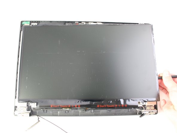

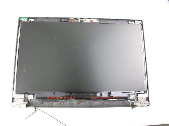

  13. Lenovo ThinkPad T480 LCD Screen Replacement, LCD Screen: crwdns2935265:013crwdnd2935265:01crwdnd2935265:03crwdne2935265:0 Lenovo ThinkPad T480 LCD Screen Replacement, LCD Screen: crwdns2935265:013crwdnd2935265:02crwdnd2935265:03crwdne2935265:0 Lenovo ThinkPad T480 LCD Screen Replacement, LCD Screen: crwdns2935265:013crwdnd2935265:03crwdnd2935265:03crwdne2935265:0
    • Remove the four 3.0 mm Phillips #1 screws from the four corners of the LCD screen.
    • Lift it up using the spudger and flip it over gently towards you.
    • The LCD screen is still connected by a connector cable so be sure not to yank or pull on the screen.
  14. Lenovo ThinkPad T480 LCD Screen Replacement: crwdns2935265:014crwdnd2935265:01crwdnd2935265:02crwdne2935265:0 Lenovo ThinkPad T480 LCD Screen Replacement: crwdns2935265:014crwdnd2935265:02crwdnd2935265:02crwdne2935265:0
    • Using the black nylon spudger, disconnect the display connector cable and remove the LCD screen.
