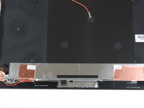

  27. Lenovo ThinkPad T460 Camera/Microphone Module Replacement, LCD Panel: crwdns2935265:027crwdnd2935265:01crwdnd2935265:03crwdne2935265:0 Lenovo ThinkPad T460 Camera/Microphone Module Replacement, LCD Panel: crwdns2935265:027crwdnd2935265:02crwdnd2935265:03crwdne2935265:0 Lenovo ThinkPad T460 Camera/Microphone Module Replacement, LCD Panel: crwdns2935265:027crwdnd2935265:03crwdnd2935265:03crwdne2935265:0
    • Use both hands to lift the bottom corners of the display panel
    • Gently flip the display panel over.
    • Potential for device damage: The display cable is still connecting the display panel to the rest of the display assembly, so be sure to flip the display panel over with caution.
  28. Lenovo ThinkPad T460 Camera/Microphone Module Replacement: crwdns2935265:028crwdnd2935265:01crwdnd2935265:02crwdne2935265:0 Lenovo ThinkPad T460 Camera/Microphone Module Replacement: crwdns2935265:028crwdnd2935265:02crwdnd2935265:02crwdne2935265:0
    • Use the pointed end of a spudger to flip up the metal bar securing the connector.
  29. Lenovo ThinkPad T460 Camera/Microphone Module Replacement: crwdns2935265:029crwdnd2935265:01crwdnd2935265:02crwdne2935265:0 Lenovo ThinkPad T460 Camera/Microphone Module Replacement: crwdns2935265:029crwdnd2935265:02crwdnd2935265:02crwdne2935265:0
    • Use the flat end of a spudger to disconnect the display cable from its socket.
  30. Lenovo ThinkPad T460 Camera/Microphone Module Replacement: crwdns2935265:030crwdnd2935265:01crwdnd2935265:02crwdne2935265:0 Lenovo ThinkPad T460 Camera/Microphone Module Replacement: crwdns2935265:030crwdnd2935265:02crwdnd2935265:02crwdne2935265:0
    • Use your hands to remove the display panel from the rest of the display assembly.
