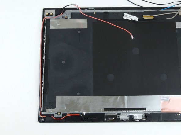

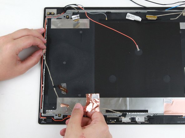

  34. Lenovo ThinkPad T460 Camera/Microphone Module Cable Replacement, Camera/Microphone Module Cable: crwdns2935265:034crwdnd2935265:01crwdnd2935265:02crwdne2935265:0 Lenovo ThinkPad T460 Camera/Microphone Module Cable Replacement, Camera/Microphone Module Cable: crwdns2935265:034crwdnd2935265:02crwdnd2935265:02crwdne2935265:0
    • Use your fingers to peel the large copper tape up from the display assembly in the bottom left-hand corner.
  35. Lenovo ThinkPad T460 Camera/Microphone Module Cable Replacement: crwdns2935265:035crwdnd2935265:01crwdnd2935265:02crwdne2935265:0 Lenovo ThinkPad T460 Camera/Microphone Module Cable Replacement: crwdns2935265:035crwdnd2935265:02crwdnd2935265:02crwdne2935265:0
    • Use your fingers to peel the small copper tape up from the display assembly in the bottom left-hand corner.

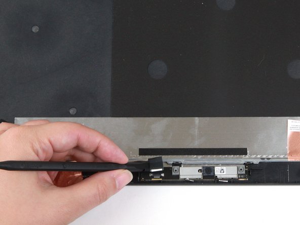

  36. Lenovo ThinkPad T460 Camera/Microphone Module Cable Replacement: crwdns2935265:036crwdnd2935265:01crwdnd2935265:02crwdne2935265:0 Lenovo ThinkPad T460 Camera/Microphone Module Cable Replacement: crwdns2935265:036crwdnd2935265:02crwdnd2935265:02crwdne2935265:0
    • Use the flat end of a spudger to disconnect the cable from the camera/microphone module.
  37. Lenovo ThinkPad T460 Camera/Microphone Module Cable Replacement: crwdns2935265:037crwdnd2935265:01crwdnd2935265:02crwdne2935265:0 Lenovo ThinkPad T460 Camera/Microphone Module Cable Replacement: crwdns2935265:037crwdnd2935265:02crwdnd2935265:02crwdne2935265:0
    • Use your fingers to peel up the orange cable from the laptop.
  38. Lenovo ThinkPad T460 Camera/Microphone Module Cable Replacement: crwdns2935265:038crwdnd2935265:01crwdnd2935265:03crwdne2935265:0 Lenovo ThinkPad T460 Camera/Microphone Module Cable Replacement: crwdns2935265:038crwdnd2935265:02crwdnd2935265:03crwdne2935265:0 Lenovo ThinkPad T460 Camera/Microphone Module Cable Replacement: crwdns2935265:038crwdnd2935265:03crwdnd2935265:03crwdne2935265:0
    • Use one hand to lift up the gray cable from the laptop.
    • Use your other hand to remove the gray wire from its slots along the left side of the display assembly.
